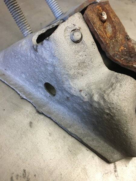

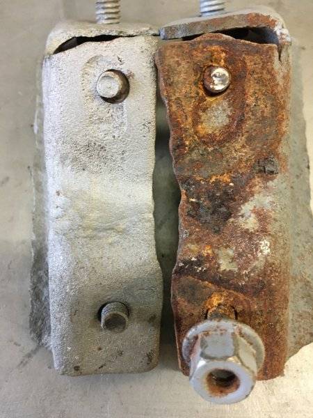

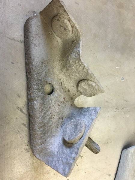

The solution ONLY attacks rust - not bare metal. The phosphorous residue is the "protectant" - not to be rinsed off. If you're painting the metal then yes, it has to be wiped down. As you can see from the heavy pitting in the brackets the rust was extremely heavy. The bracket on the left was soaked - probably for a couple days - then left to dry which left a powdery coating. This was done a few years ago and the piece has been handled often since, rubbing off most of the powdery finish but it still displays no surface rusting. This stuff beats the hell out of all the other "snake oils" on the market and the REAL bonus (for me anyway) is that A) its made locally and B) its UNDER $20 a gallon !!!

I don't think that's phosphoric acid though, that looks more like a rust remover, the acid leaves any rust spots gloss black.. BUT i want a couple of gallons of that stuff.. sick of seeing $60 a gallon for like evaporust.
