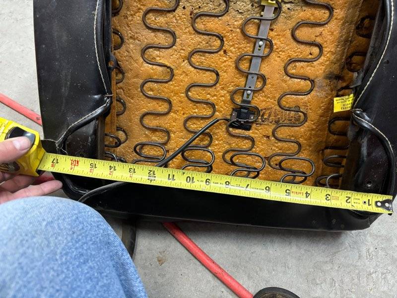

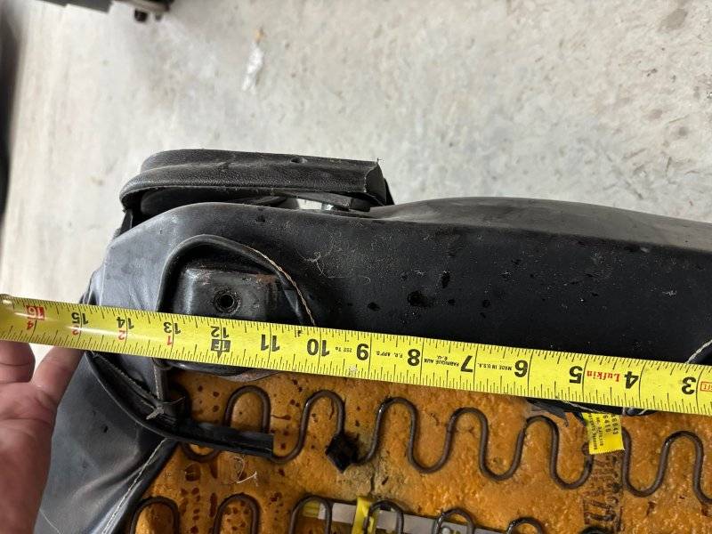

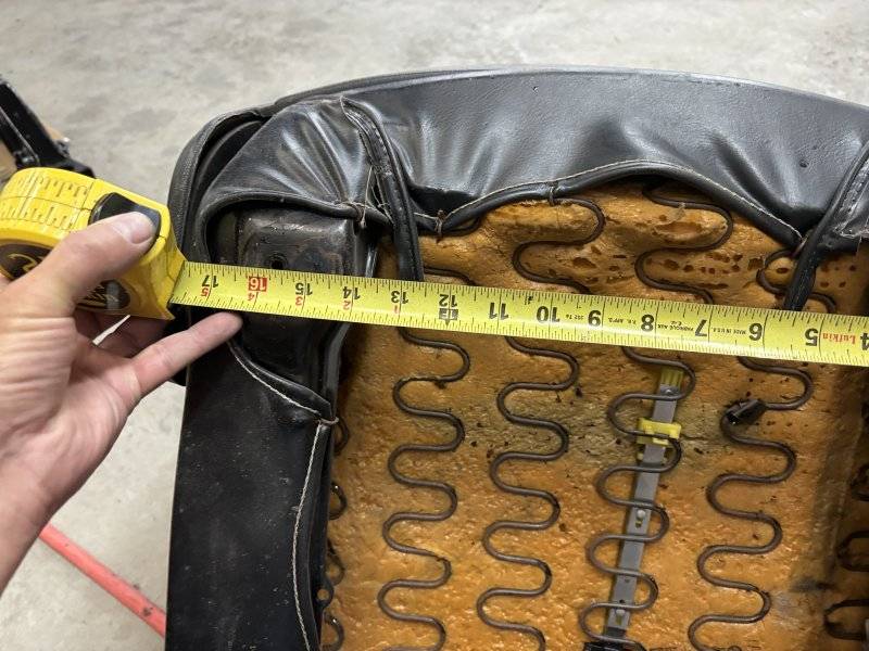

The seat frame dimensions are 14-5/8" center to center at the rear, 14-3/4" in front, and both sides are 12" center to center front to back.
