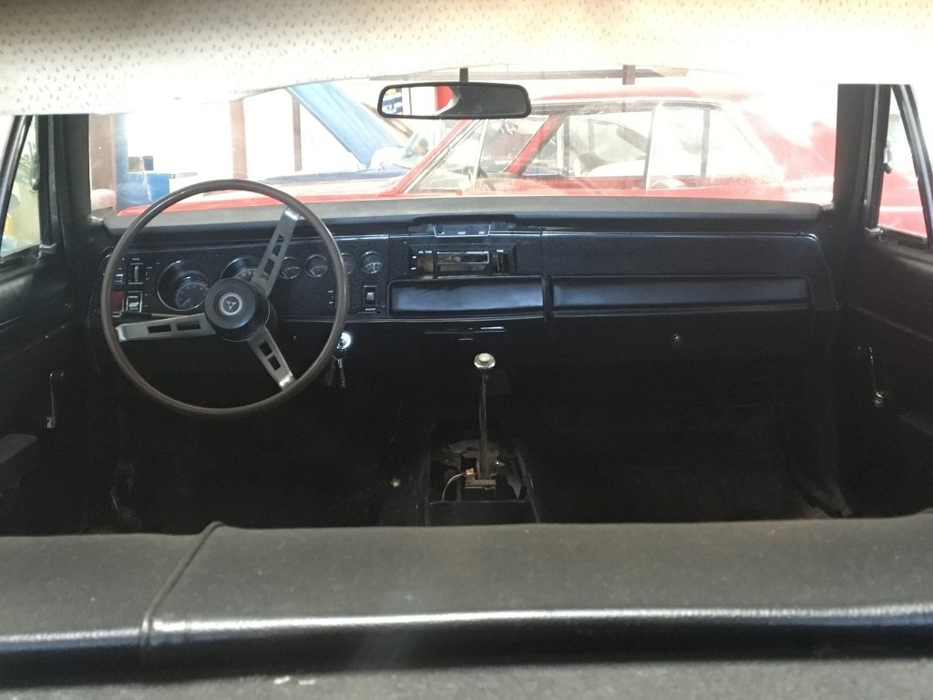

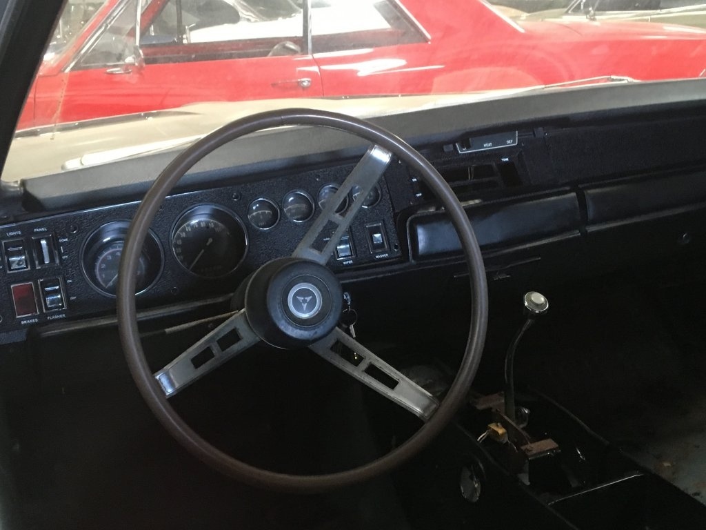

Amen to that.------------------Mopar Brother(s) Stanton, Moparnation,Beekeeper, have been a tremendous help to me. I value there input/advise!!!! Im putting in my switch panel into the lower dash pad without switches installed. Should be a real thrill to install switches from under the dash. I didnt have a philips screw starter but bought one just for this job. The rheostat and light switch seem to cause the most trouble trying to get through the dash pad. Good luck
