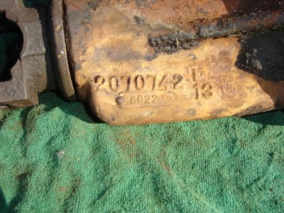

I'm trying to find a "correct" 742 case for my 1963 Savoy restoration. Are there any clues what I should be looking for? Is the orientation of the big "2" different in eg. early vs. late pumpkins? Were there different manufacturers that used different markings?

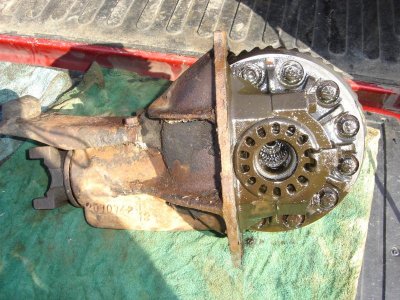

081.jpg080.jpgThese are pictures of a bone stock 1966 742 power lok{ suregrip]

My understanding is that the Max Wedge cars had 742 rears. My 1963 Fury (with 318 wide block) has a 741 rear.
Any pics of the machined pad with stamped gear ratio?
