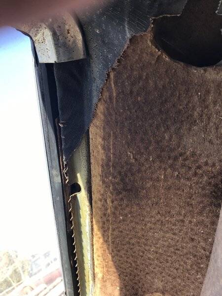

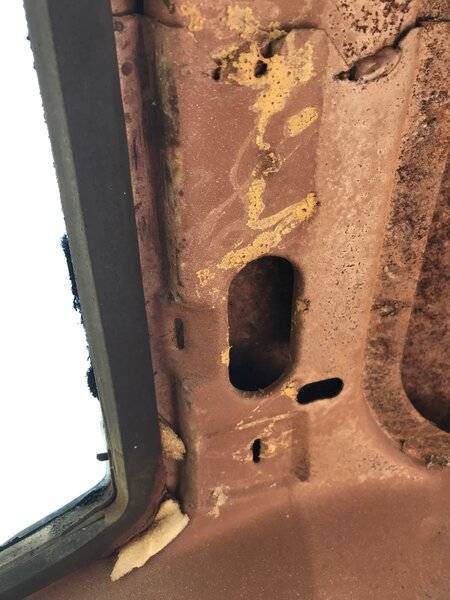

I'm looking for pictures of the inside of a 1966 Belvedere II, 2 door HT. I'm really interested in the rear window opening along the sail panels and roof line. Preferably with the headliner out. I can't seem to find the screw holes to mount the interior chrome trim around the rear window. My thinking is if I can see the bare sheet metal around the rear window that would give me a better idea on screw holes. Thanks in advance. Rick

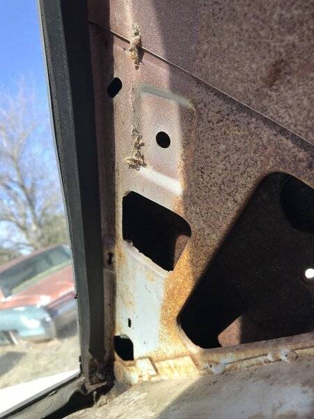

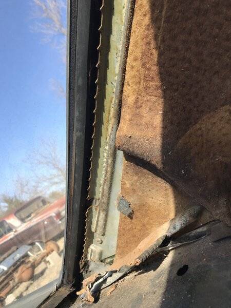

Rick, These are from a 67 Belvedere II but look just like the 66 Satellite I have.
66 Satellite, after removing the "chrome" trim. Screw slots are behind the cutouts in the headliner retainer strip.
Hope this helps you. Bret

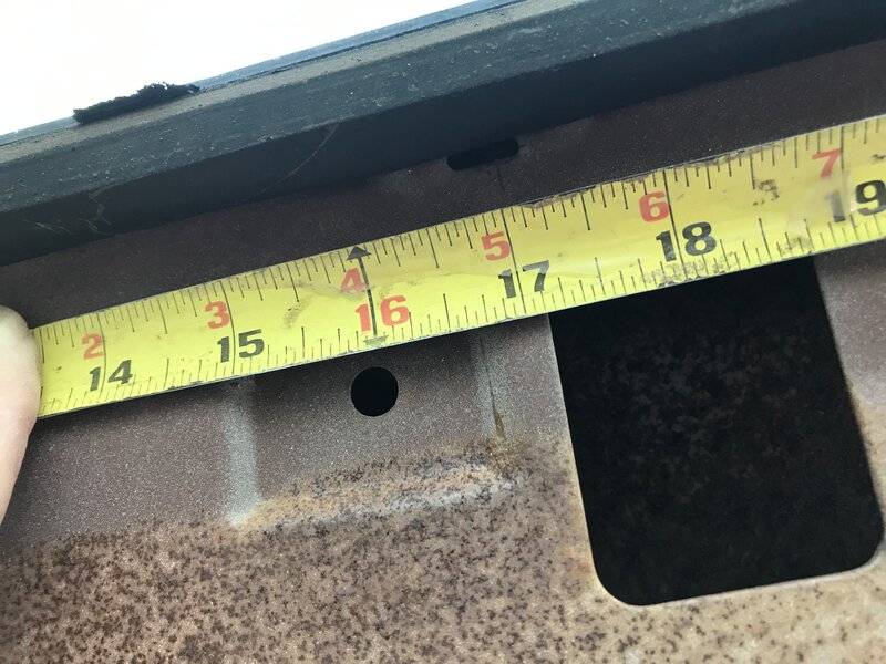

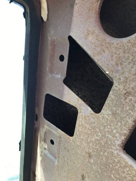

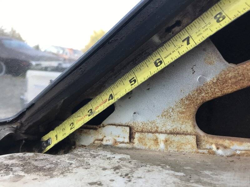

Thanks, Big help. Would you have time to take measurements from the package tray up the side of the sail panel for the mounting holes? And it looks like the screw holes are close to the rubber window seal? When i use a small pick to find the screw hole all I'm picking up is dead space. Again, Big Help. Thanks Rick
Two pictures of the same measurement, the 17" is the top hole of the sail panel. When I tried both holes in one picture it came out too dark to see.
