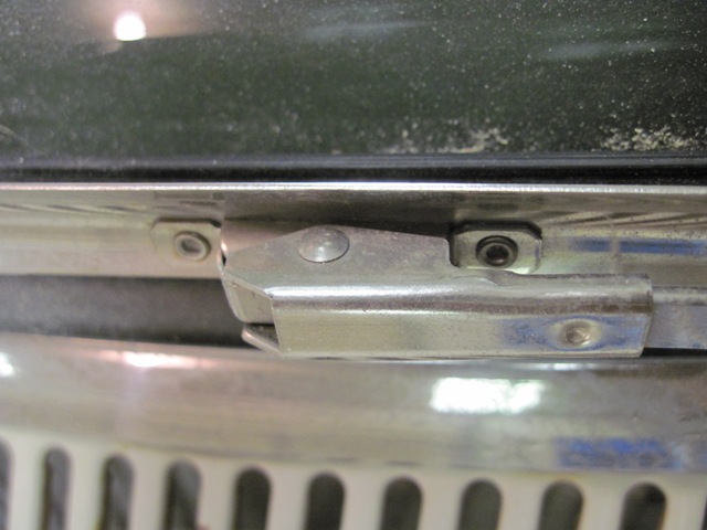

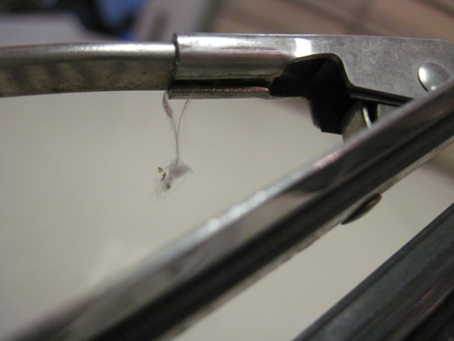

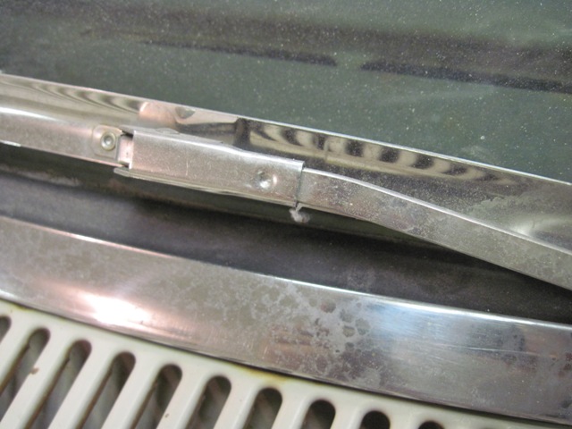

Here are some pics Bob.This is the drivers side wiper. Hope this helps.

The end of my wiper arm has a hole in it roughly 1/8" in diameter. By looking at the wiper arm it appears that at one time there may have been a pin, much like the one on the you push in to install a refill. There is no dimple like the one shown in the photo. There is a small flat spring in the pivot that would have acted as a capture point for the pin on the end of the arm...
make sense???
