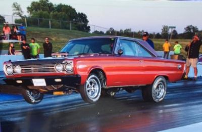

As of right now I do not have a pinion snubber that works that is because I moved my rear end back 1 7/8" to make room for tire height. I am pulling 1.33 60ft with ss leaf springs, I have an adjustable snubber but it is not hitting the floor pan so before I went through all that work of welding an extension so my snubber would hit I would ask you all if it is worth it or not. I know my rear end is rolling so much that my shocks are getting beat up because they are hitting the axle tubes.

Not sure how well you all can see the rear end under the car in the picture. But it is def more of a bottom end car especially with the 440 stroked out to a 499 and the fastest I have been is a 9.90 at 132mph. That is foot braking by the way. I have been praying over my leaf springs alot of other people I talked to could not get them to work. Yes as of now the car is really consistent even in the heat. I can only get a 10.5" wide tire under her but I moved the rear end back enough to where I can get a 31 but right now I have the 29.5 X 10.5 which actually measure 30.5 X 11. My rear end pinion angle is also looking down pretty hard and the rear shackle angle is angled back pretty hard thats why I think it is working so good.

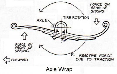

he's having a real axle rap issue, if you read his 1st tread/post
he says;
"the rear housing rotates & contacts the shock, because it rotates so far"
{paraphrasing}
just pointing that out
IMO a pinion snubber possibly could help that one issue,
he's making more power than they did back then too
& it still will allow the rear of the springs to work properly
& lift, instead of rotating the rear axle excessively so much

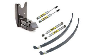

by the way Mopar Performance offers a kit for MP 203112 S/S spring kits,
IIRC in an older catalog, may have been from old Mancini Racing site too
that includes a adj. pinion snubber now too,
see photo below, I can't remember where I got the photo thou
In their old MP Book; Chassis 9th edition P5007160 it even touches on it
on page 316 {among other places} in the rear suspension section,
It states with a manual trans it should always use a snubber &
with an automatic
, "don't necessarily required one"
it doesn't say, not to use one,

I like Cranky' suggestion of adding a leaf portion on the drivers side,
that would probably help it to leave far more level too, with less axle wrap etc.
a pinion snubber would/could be a band-aid, but may prove useful too
obviously it's working pretty well or he wouldn't be getting a 1.33 60ft
