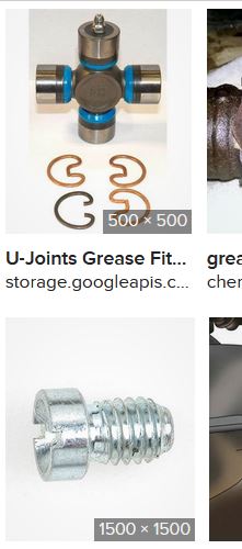

U-joints are made with ability to grease through a cup. The grease gun need to have the tip like a ball with a hole for the grease to come out. Manufacturers don't seem to make them widely available or I haven't looked that's true. If I can find a pic I'll post it right the search is buffering WTF!
