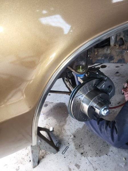

I recently purchased a power brake disc brake system from Pirate Jacks for my 1970 Road Runner.. The installation of the rear discs went great, no issues. Having major issues with the front brakes. Calipers will not fit over the rotors. It appears that the rotors are not sitting far enough back on the spindle. Ther is a gap of over 1/2" between the rotor and the back plate. After putting on the nut, it is even with the end of the spindle and wouldn't even come close to allowing a cotter pin. Anybody else have this issue?

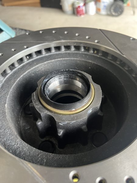

post a picture of the seal youre using
The rubber lip doesnt seal over the bearing, it seals over the step on the spindle
Here you go. I assume this does not go like this?

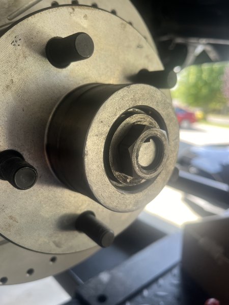

More Pictures. Rotor wont go back any further than this and bearing is all the way into the rotor. Calipers will not go on. Its like race is not down far enough into the rotor.

I bet the inner big race isn't all the way in. clean behind it and look carefully, if there is a space under the race, the race needs to go all the way in. Find a race installation kit (Aluminum discs) and tap it in. If it is stuck, take the race out from the other side with a brass drift and check for burrs etc.
