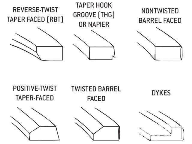

A Napier 2nd ring has a hook cut out to act as an oil scraper, and I believe it could just be a square cut out also.
