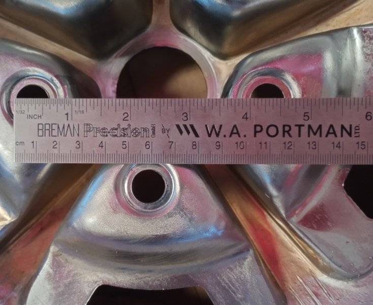

Here's a pic of the wheel

Mopar small bolt pattern.
No. The small bolt pattern for Mopars is a 4" circle. According to a Google search, some Fords in the past 10 years had the weird 4-1/4" pattern.
In my opinion, modifying your car to fit oddball wheels would be like buying a hat that is too small then having your head surgically altered to fit the hat.
How about modifying the wheels for that oddball (IMO) unilug plug solution from years back?
Are you sure? I though on 5 bolt pattern you measure from the outside of one hole to the center of the opposite hole.
It looked close and logical. I always use a cheap plastic bolt pattern gauge to eliminate guessing.
