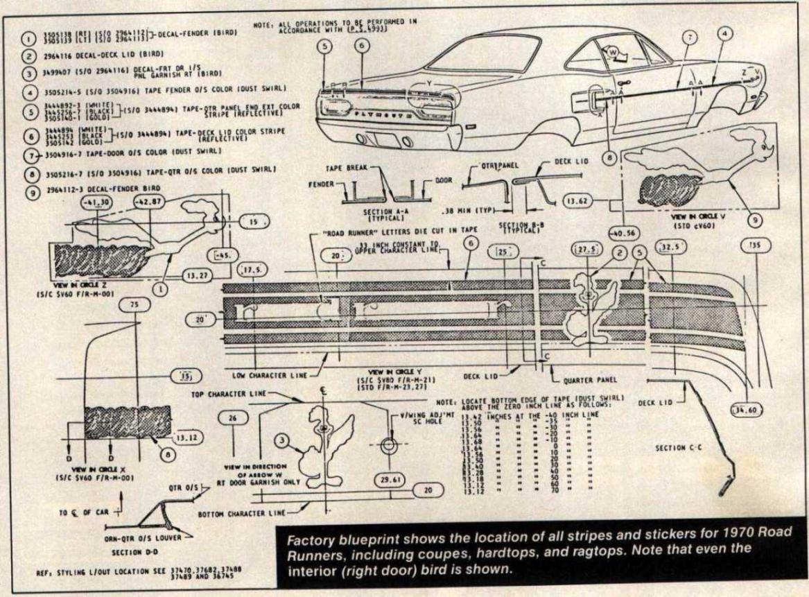

Anyone have any info on the placement of the running and standing birds on a '70 road runner?
Thanks in advance for any help.
A few pictures are worth a thousand words. :grin:
Richard

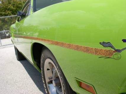

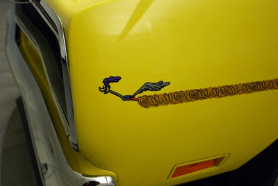

No one besides me noticed the bird on the yellow car and green car are different?
You guys are slipping
Hey Tem,
I did that on purpose. You win what's behind door number 1! :grin: (See attached photos) The green car has a custom bird and it doesn't use the middle finger like the GM and Ford owners show us as shown in the third attached picture below after getting their doors blown off by just about any Mopar!. :grin:
