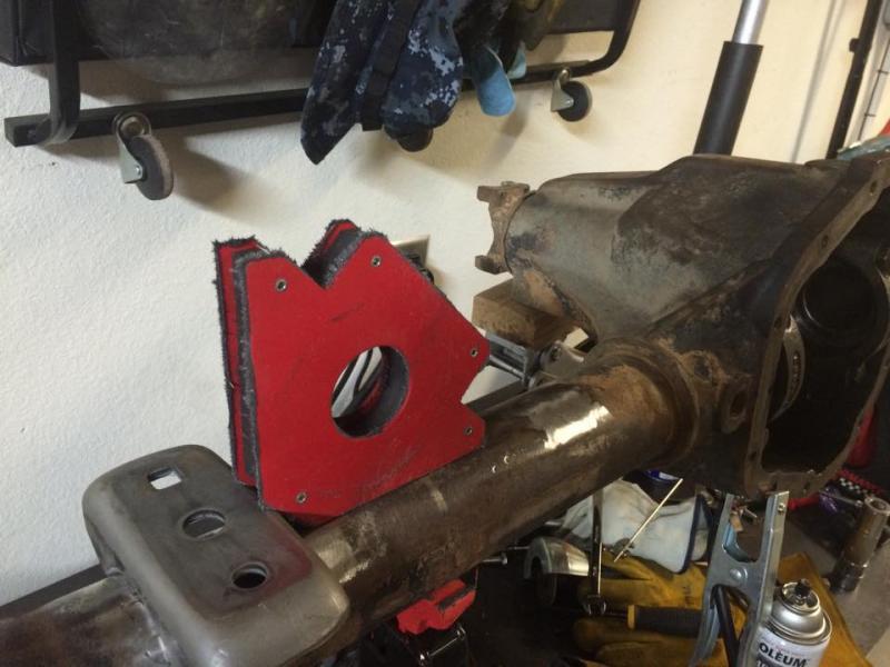

Possibly a dumb question, but I need help as to which way does the square hole on the perch go? towards the front or back?
All the the pics I took I cannot get a close look, all the pics I find online are too close to see the orientation. This is a Bbody Dana 60 I scored off of craigslist that I'm moving the perches back to stock.

That is strange the FSM shows round holes. Wonder why the square hole for a round bolt? Is there a difference in hole spacing from the alignment pin hole to the outer holes? Will measure my Dana in the morning.
I do not believe it matters the only hole that matters is the center hole which the spring nipple fits into other than that The u bolts don't go through those holes.

I was thinking this was true about it not technically mattering, but I just wanted it to be in the correct stock orientation. Thanks for the reply though, sweet Ranger, I drove an edge the Navy, love em
