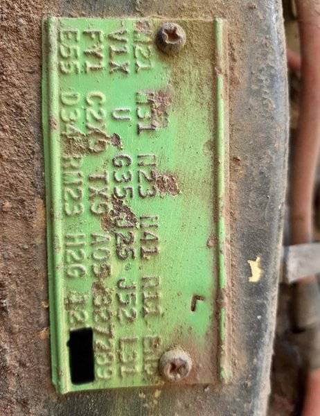

Anyone able to decode this for me?
72 road runner 340 auto in yellow black vinyl top. Built Oct 1, bench seat black interior built for the US. Others will chime in with the option codes
'72 Roadrunner hardtop 340 car...couple of numbers I can't make out from the pic. Here's my 3 minute plug and play on this link...1969-1974 Mopar Fender Tag Decoder
RM23:
Plymouth Belvedere,Satellite
Medium, Road Runner
2 Door Hardtop
H2G: 340 240HP(net) 1-4BBL 8 CYL
1972
St. Louis, MO, USA
: Sequence number
E55: 340 cid 4 barrel V8 275hp
D34: Light Duty Automatic Transmission
FY1: Banana (Dodge), Lemon Twist (Plymouth) Exterior Color
: Trim - Unknown, Unknown, Unknown Color
TX9: Black Diamond (Dodge), Formal Black (Plymouth, Chrysler, Imperial) Int. Door Frames
A05: Build Date: October 05
: Order number
V1X: Full Vinyl Top, Black
U: USA Specifications
G35: Delete Standard Outside Mirror
J25: 3 Speed Wipers
J52: Inside Hood Release
L31: Hood/Fender Mounted Turn Signals
M21: Roof drip rail moldings
M31: Belt Moldings
N23: Electronic Ignition System
H41: Heater w/ Upper Level Vent
R11: Radio Solid State AM (2 Watts)
