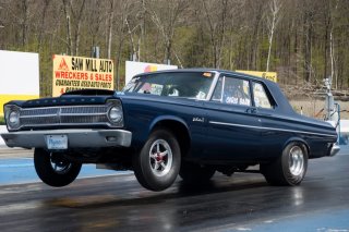

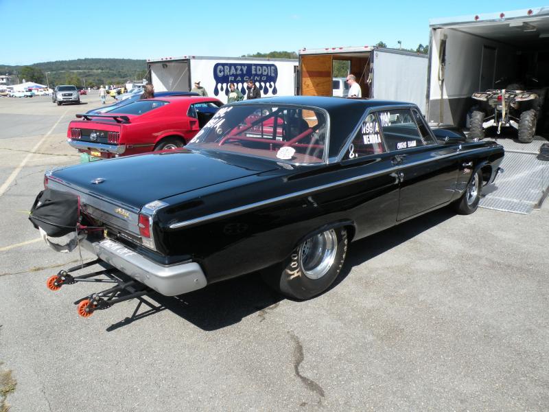

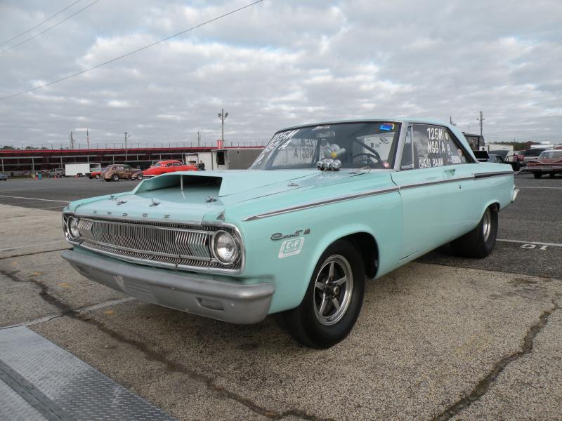

PROGLASS. best out there 1/8" and 3/16" thickness. he will hook you up. my Black dodge, blue dodge and hemi belvedere all have it. Best fit.

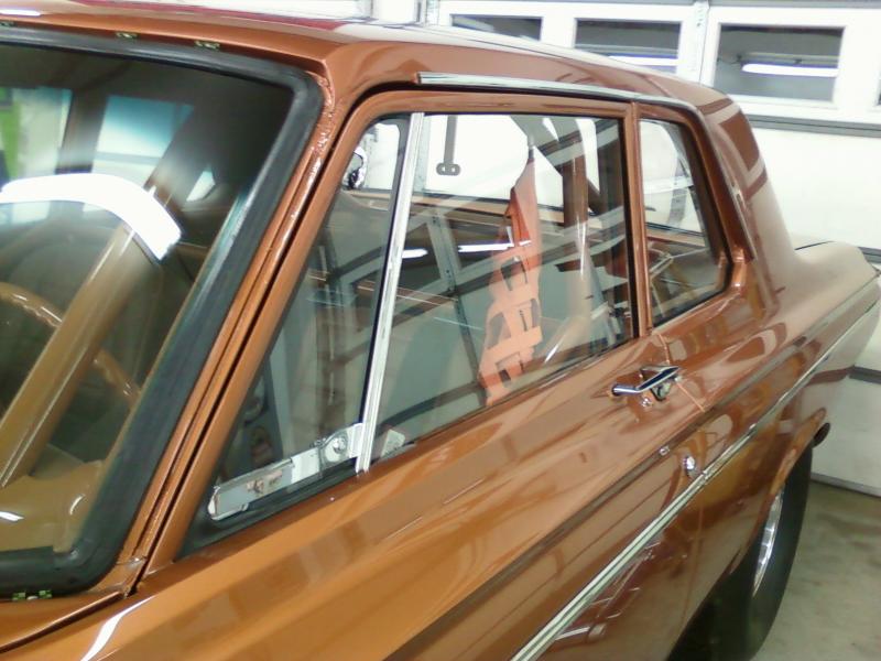

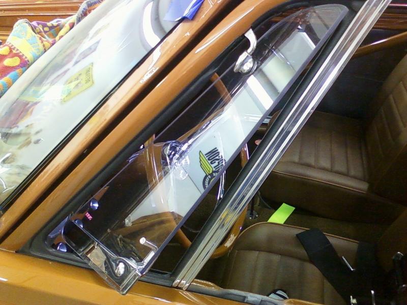

I cut all mine from 1/8" lexan. The rear window fits into the rubber. 1/4 windows are fixed. The doors go up and down with straps. All edges are sanded and look stock. The vents are 1/4". the windshield is stock. This saved 84lbs on my 64.

those are the nicest plastic windows i have ever seen dvw!nice work.lexan for sure on the choice between the two ryguy.plexi not only yellow with age but cracks and splinters as well.
