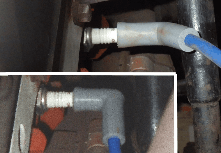

I had several straight boot plug wires I had issues getting on in my Abody for lack of space. I ordered 90° boots but was sent straights.
Here's #7 and a straight boot. Right up against the steering. Could not get it on until I lubed the boot and slid it up the wire. Got the connection made then slid the boot down around it. Could have waited for the correct boots ..........but I didn't, Lol.
A couple days later a full set of 90° boots the supplier sent showed up. Worked fine and dandy........
