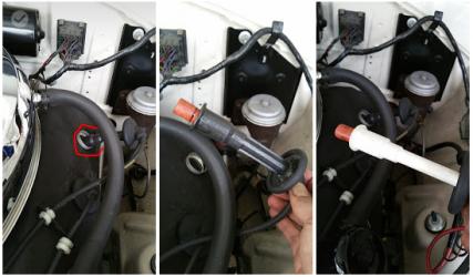

One of my plug wires keeps popping out. The actual plug shown in the picture with the black sleeve is hard to push down the tube. The other 7 plugs have the white sleeve and fit down the tubes easily. the spark plug appears to be seated well, ie it does not appear to be cross-threaded or anything. i have not had time to switch the wires. I have not taken this valve cover off recently. appreciate any insight, this is a recent issue.

It could be that the part metal end that sits on top of the plug doesn't have enough tension to hold it on. Simply, just stick a loose plug into the end of the wire and see how it grabs it.
thank you Sir. i will try that. I will also pull the plug and see if i feel pressure coming out of the tube. will report back.
