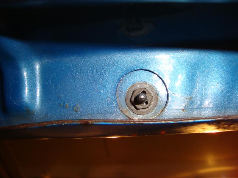

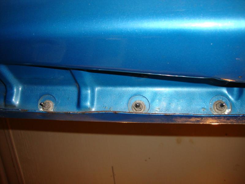

it's a 68 GTX, but i think they are the same...

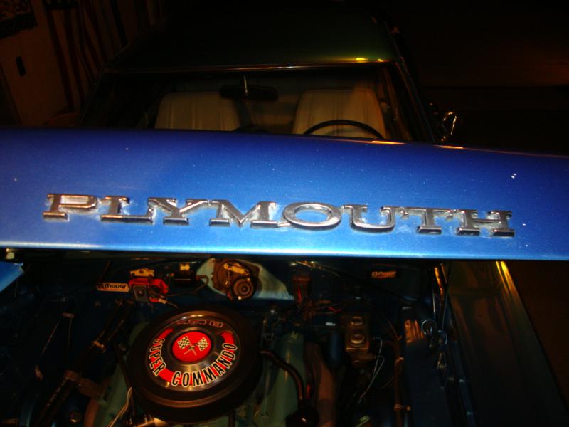

Another example:
Hood emblem

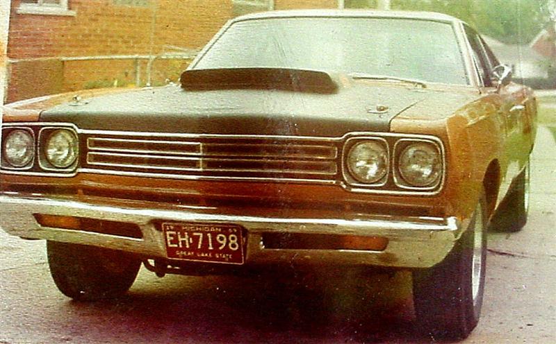

The exception to the 69 Plymouth hood emblem is the 440 6bbl which had no emblem on the hood.
