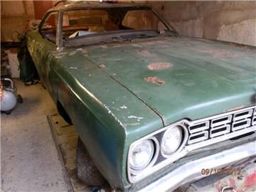

Guys, hello! My name is Dima, I am 32 years and from distant Russia)
In 2011 I bought the remains of Plymouth Satellite 1968 and began restoration.
A bit of history.

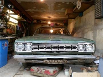

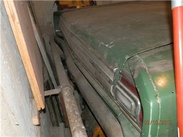

The car came to Russia in 1978 (in the previous topic sealed).
Here is a photo of the car near the Ministry of Foreign Affairs in the 80s.
during the Soviet era was a very difficult adjustment.

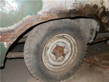

In my car due to lack of spare parts in the country to put in the rear axle, brakes and front suspension of GAS 24.
In Soviet times, the car lost a huge amount of original details. Cluster, wiring, suspension, brakes, shaft drive, and more.

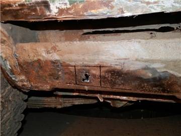

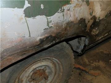

Also the car is quite rotten and cook with gas. The rear arches, sills. He looked terrible. Instead vinyl stamp was unprecedented animal skin))))))
A little later, I continue with the photos. We need to take a walk with the dog)
As such, I bought a car.
It was very sorry to see the car in such a way. Moreover it is the only two-door coupe in '68 with these documents.

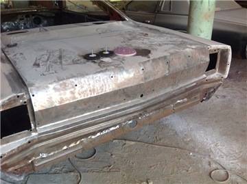

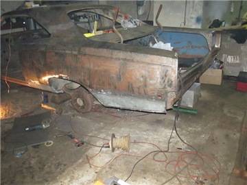

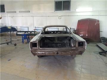

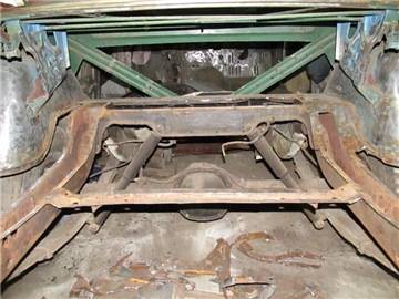

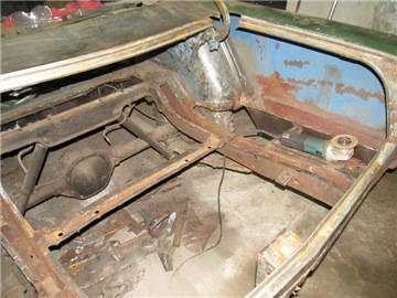

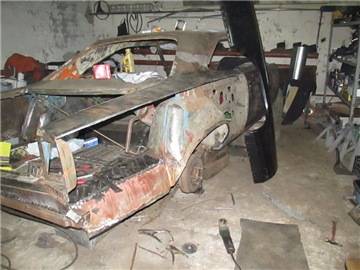

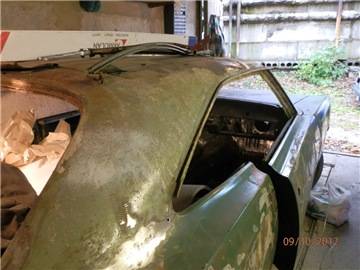

At first I started to manually clean the body from corrosion.
After that, the body was sent for sandblasting.

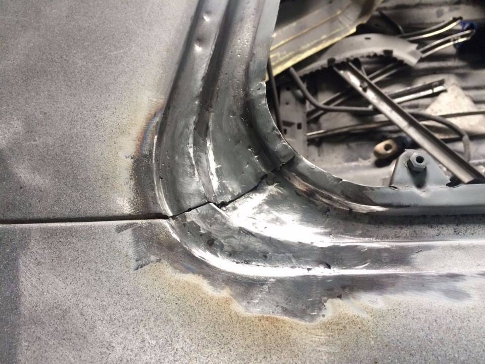

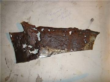

It became clear that the need to replace the rear fenders, sills and boot floor ((((
For example, the rear wing on rokvato worth 157 dollars, and shipping in Russia 500 dollars. Gone to save all of it to buy.

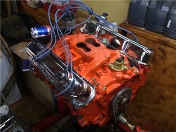

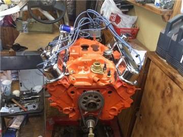

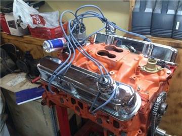

In return, the native incomplete engine I bought the 360 engine and the automatic transmission 360 from the bus Dodge 1985Motor I went through.
Each element of the fine motor I gave in anodized

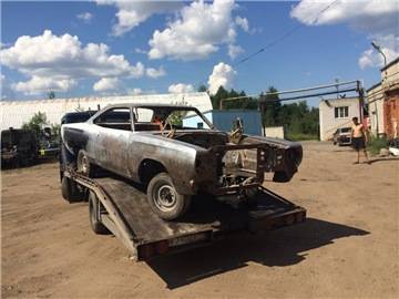

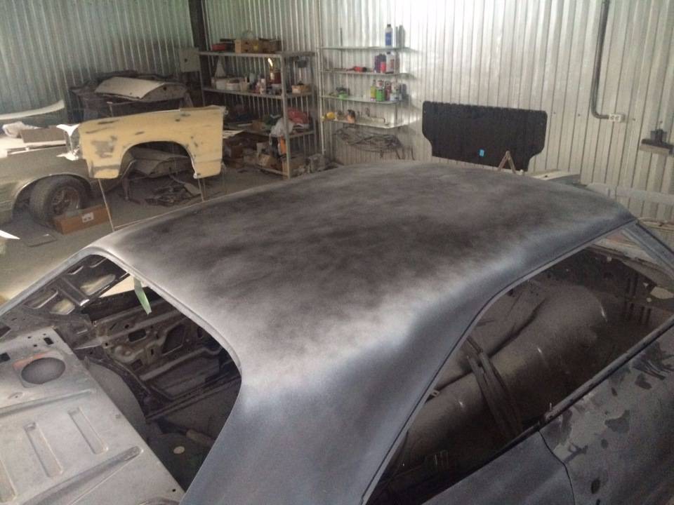

Guys, hello! New photos, the car in the development soil.
