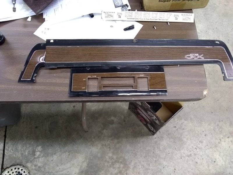

So how and what are you using to polish your GTX dash pieces? Mine are in pretty good shape, just wanting to bring the shine back without damaging them.
I had to buy the upper left piece and you can see how shinny it is.
Use plastic polish by hand, terry cloth then microfiber. Meguiers has some stuff that works well. I wouldn't use any buffer or wheel on these. Usually they're brittle and catching them the wrong way will break a corner off or crack them.
Yeah, if it's plastic, Meguiar's Mirror Glaze Plastic cleaner (#17) and Plastic Polish (#10) works great.
I used a bit of Simichrome and a cotton t shirt. Plastic polish would work just as good.
