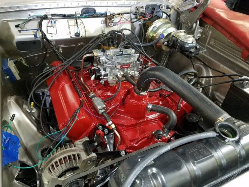

After a complete rebuild of my poly including .60 bore, slight cam, solid lift, Eddy 4bbl, headers, I'm disappointed with the anticipated extra giddeeup...should have took it to the next level stroking it...
