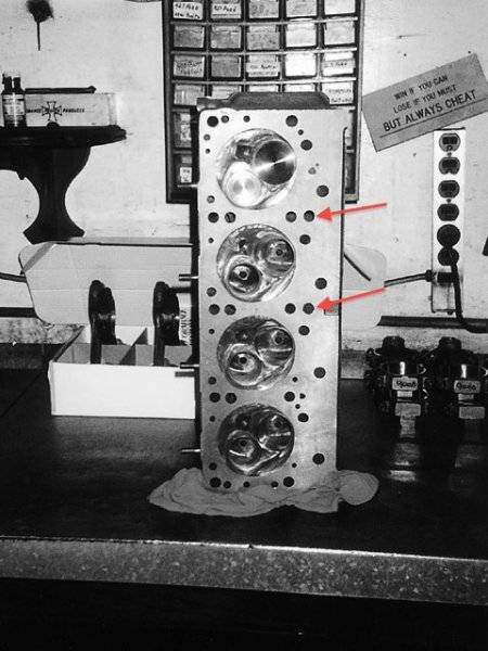

can 318 poly heads be installed on a la 318 block
You'd have to plug or block off a couple of steam passages that don't have corresponding LA block holes, but that isn't a problem.
And because of the different valve orientation, you'd need different pistons. And a one-off cam grind. You'll have to grind pushrod clearance grooves and add an oil drainback line. The heads themselves can be ported to supply 500+ horsepower.

So basically, not compatible.
