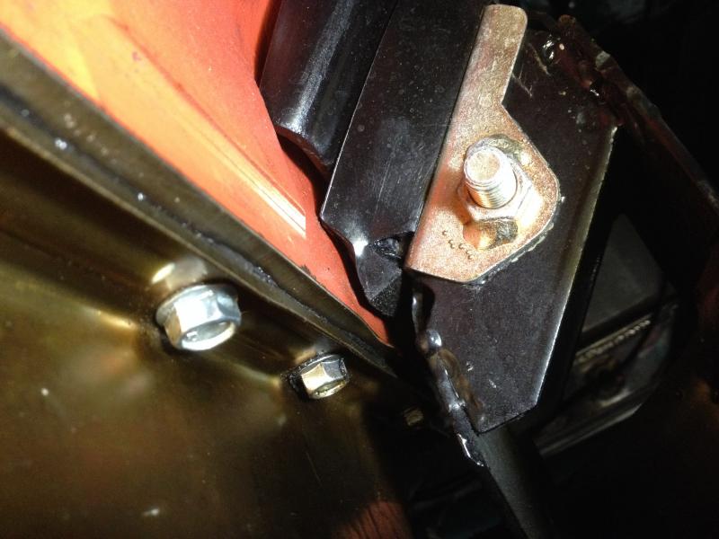

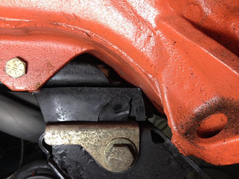

Here is the scoop on the mounts from Schumacher. Just got off the phone with Schumacher. I have a customer car at the shop that has the mounts that have failed(see Pics). Schumacher recommends making a heat shield over the mount if you are running TTI headers. They are close to the mount and the heat will ruin the urethane. Schumacher is covering the mounts under warranty.
