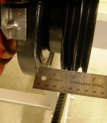

I removed the A/C and 3-groove crank pulley from my engine and replaced it with a 2-groove crank pulley from my other engine, here are the measurements. From the face of the balancer to the center of the 1st pulley groove 1 1/2", to the center of the 2nd pulley groove 2 3/16".
My engines are '63 but should be the same as your '64. the 1st pulley is (WP/ALT), 2nd pulley is (PS), hope this helps...Nick T.

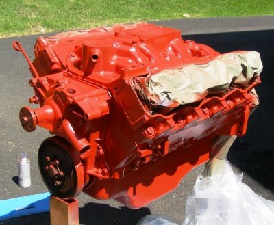

firedome, the next thing to do is measure the crank pulley. Since mine is mounted I'll measure from the inside back mounting surface to the balancer to the outside leading edge. If our pulleys are the same, and our balancers are original then you'll have to look at the water pump shaft length. Now here's where the problem may be, you said "if the distance from the front face of the water pump pulley attachment (cross shaped thing) were about 5/16" more all would be fine". My water pump pulley attachment is a (round shaped thing). Tomorrow I will measure the crank pulley...Nick

My parts guy swears that both A/C and non-A/C water pumps are the same for a 318 poly, and Rock Auto doesn't differentiate when searching by their menu selection... oh, and all the replacement pumps I've seen have the round fan attachment as in Nicks picture above, but the 2 original pumps I have both are cross shaped. I've ordered a new pump just in case. Next I'll measure the crank pulley as furyus63 suggests.
