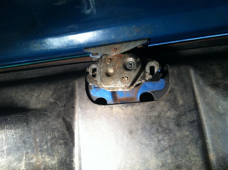

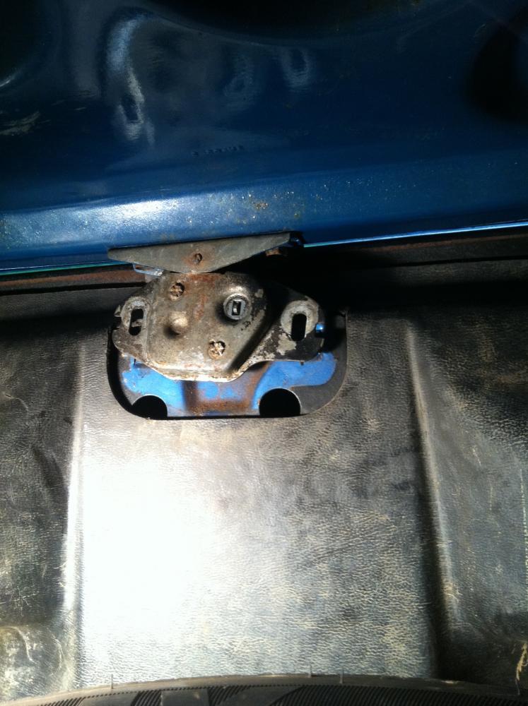

I lost my trunk key and so I thought popping the trunk would be an easy task but I have not figured out how to do so. I had assumed that the tab poking through the locking mechanism would allow me to release the latch. Then I loosed the bolts to see if any progress could be made. Now I'm wondering if I could crawl back in there and and unbolt the deck lid from the latch itself, but surely I am missing an easy step? Has anyone had to do this before? Thanks!
I once slid a skinny screw-driver in beside the bar, and twisted the whole works with vise grips. I straightened the bar out after disassembly. That was decades ago.
Or, now that it's unbolted, see if you can poke behind it to remove the c-clip and pop the lock out. Then you can easily twist the slot and unlatch.
Like mmisil said use a screw driver in the slot and turn it just enough to pop the lock. I have done it several times.
And don't worry about destroying the bar ,most if not all locks come with a few diff sized new ones . I'm assuming your going to replace the lock after all of this ,
If for some reason it won't turn to easy just cut the little rod then push the remains out then twist the latch . Good luck
When I got my '70 it did not have a trunk key, Had to crawl in there and unbolt it. Uncomfortable but effective.
- JDB
3 - 4 ft of 1/4" rod or threaded rod. Form one end into a screwdriver tip by grinding or hammering. Bend an "el" in the other end. With the seat back off firmly insert the tool and turn counter clockwise.
Thanks for all the tips. I ended up backing out the bolts from the trunk lid, and now I see how the whole thing is put together AND why I should keep my spare keys handy.
