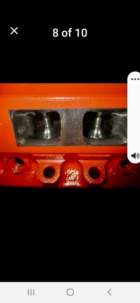

someone has a set of ported heads he calls them stage 3 and the stage 4 he calls race heads. would the stage 3 hurt bottom end power. still has the 2.08 1.74 valves. only have 2.94 gears and 2200 stall converter.
IMO, there are no 'standards' for these terms, although there probably should be.
If by, stage-3, he means final max wedge ports sizing and shape, then yes it would hurt bottom end, and you would need an intake specifically made to use that head design.
Pix, and more info may help with your query.
photos
Trying to not be a smartass, but the truth is…….there is only one way to know for sure how those heads would compare to your current heads, on the current combo.
And that’s to try them.
If you get them, it appears they have aluminum retainers.
It would be wise to change those out.

IMO, if they are done right (picture are not enough to know) and flow 260-ish and going on a 440, they will help everywhere, probably a lot.

While it’s certainly well within the realm of possibility that those heads could flow 260-ish, the number of home ported(or done by a shop that doesn’t specialize in porting) BBM factory iron heads I’ve had on one of my flow benches since 1993, reaching that threshold, I can count on one hand.
Most are typically in the 240’s range, especially the 915/906 heads, where you really need to get after the SSR to keep them from backing up after .450-.500 lift.
That being said, it shouldn’t be hard to improve on unported, stock valve size, 516’s.
