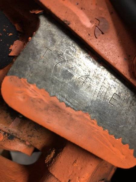

I did find (under paint) the deck stamp, which, as best I can decode, indicates it was originally a cast crank based on the “e”, but I could easily be wrong or it could have been changed out at some point.
