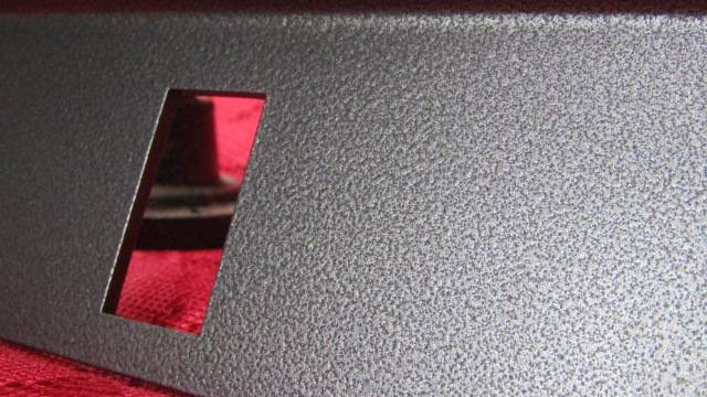

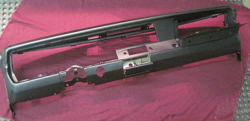

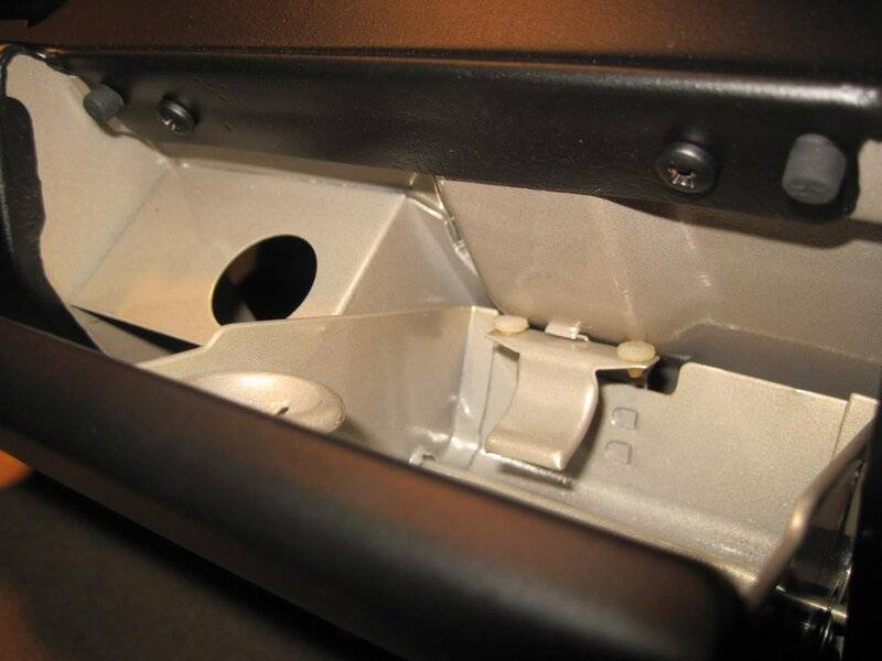

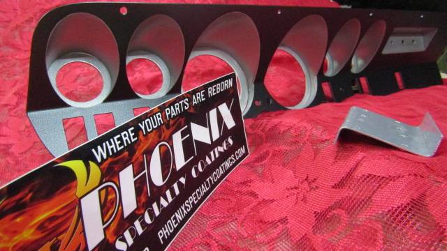

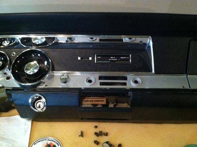

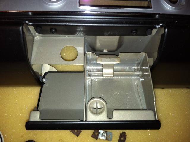

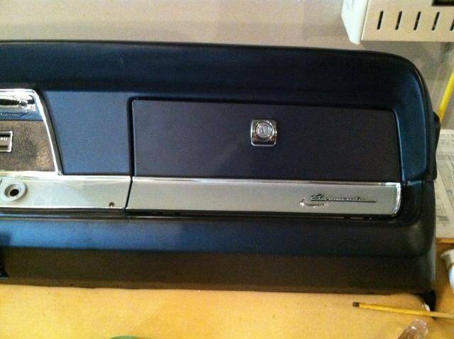

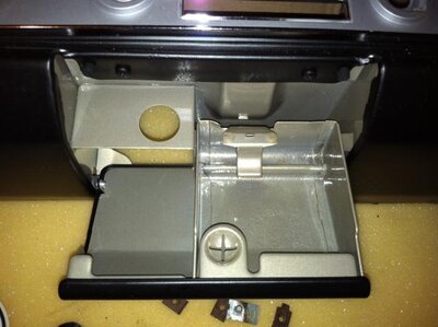

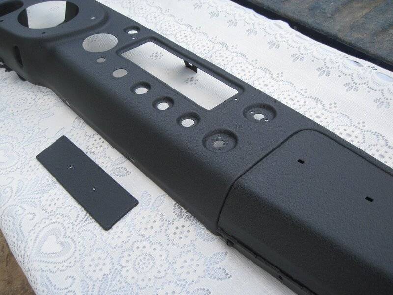

Since this thread is about powder coating a dash, I'll toss these in even though your decision has already been made just for illustration purposes. The first is for an A Body convertible, the second is for an import (MG) and the third is most of a famed Rocky Mountain Dash insert all with different finishes. (The glove box portion of the RMD has yet to arrive.)
The A Body was done in satin black with its ashtray in a goldish silver, the MG's was a black wrinkle texture, and the RMD was finished in a black "leatherette" (it really does look like leather!) with metallic silver gauge pods matching his color sample. All of them have a bare spot somewhere on the back matching the factory's for grounding purposes. Keep in mind too @themechanic that all the little plastic/rubber bumpers and protective sleeves are half a century old and need to be carefully removed if you plan to clean and reuse them. (A blind riveter would be handy to put the ashtray assemblies back together like the factory did too but is unfortunately not in my budget for the occasional frames that arrive here.)

The masking for this one was really ..................... fun. :bs_flag:
The pod backs were just tacked in place in 2 or 3 spots leaving a slight gap around every perimeter.

Here's a close up of the leatherette.

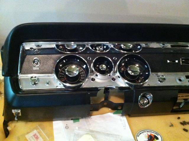

And, would that Cuda dash be this one here? Still looks as good as the day you did it!
