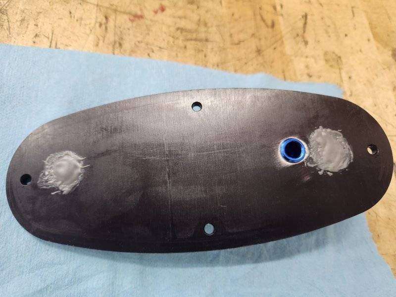

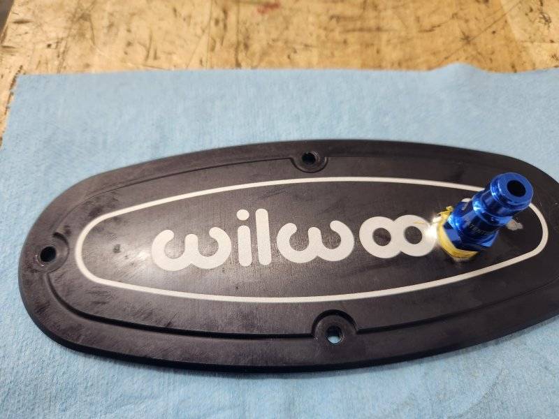

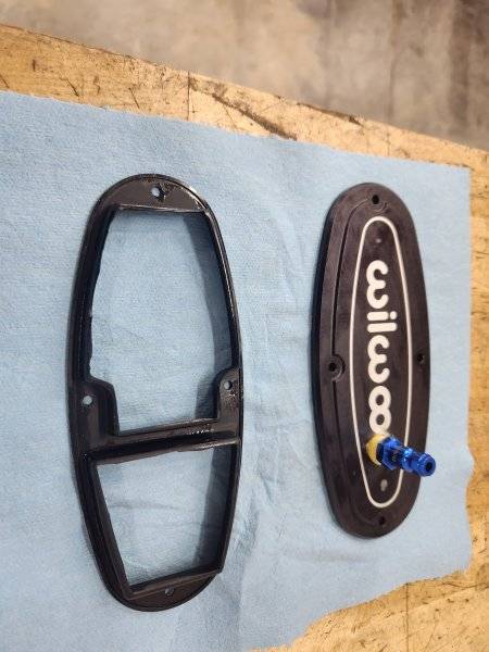

Hey folks,
I have the Motive products power bleeder and love it! Only issue was trying to use it on my Wilwood master. The adapter Motive recommends didn't work very well. It leaked like crazy regardless on the number of clamps I used.
I found on YouTube a guy that made a custom adapter from a Wilwood cover. I decided to give it a shot and it worked perfect.
Here's the link.
