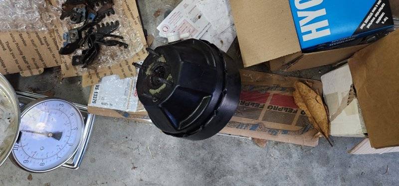

my 69 Charger has no booster and MC when I got it. So was wondering what style of setup, Factory or Hydroboost, ect gives the best braking? Thanks, Factory front disc and drum rear
Your Charger probably had a Bendix booster from the factory.
I would say the hydro boost system but, probably a lot more $.
Mike
I vote for the factory set-up. Mopar engineers did all the research for you. Brakes are way too important for trial and error. Get the proper dual 8" diaphragm unit and factory style master for disc / drums. Your life may depend on it.
