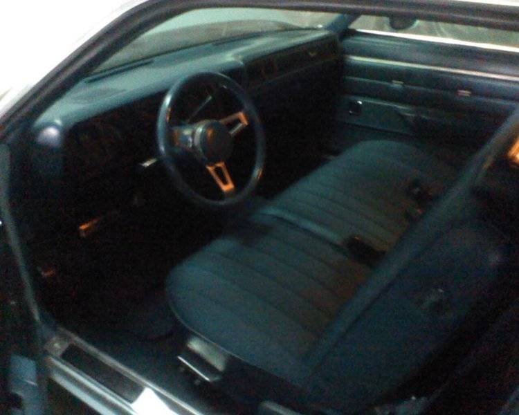

Hello to all, Just a quick question...Were power seats ever offered with the bench seat in e-bodies like the one pictured?
nope
no power seat ever came from the factory in a E body..
nope
Thank you for the quick reply. It's my understanding that the seat tracks for this seat uses the outer tracks from the the bucket seats, correct?
The problem is the seat height. There is very little headroom even with the six-way manual adjustable seat.
The left track is the same as the drivers outer track but the right track is not the same as the inner track. The inner tracks are taller. I have made them work using about 1" spacers.
The reason for my questions is I'm contemplating putting one of these in my late b-body. The stock bench seat even with the power adjustment at the lowest level is still to high for me. Installed factory buckets measure 4 inches lower but I'd prefer this e-Body bench seat if its as low as the bucket seats AND I can put power tracks under it. What do you all think?
