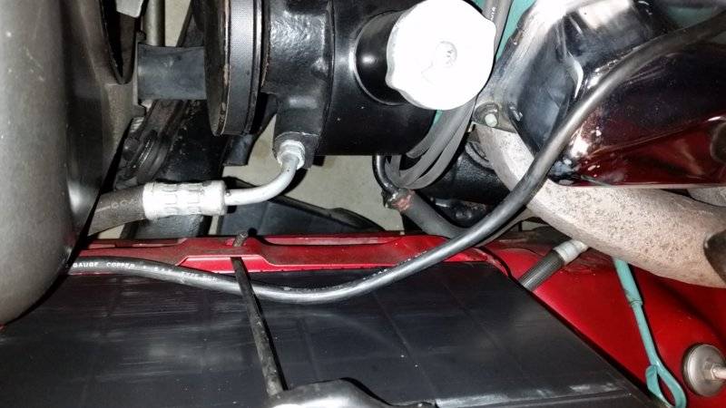

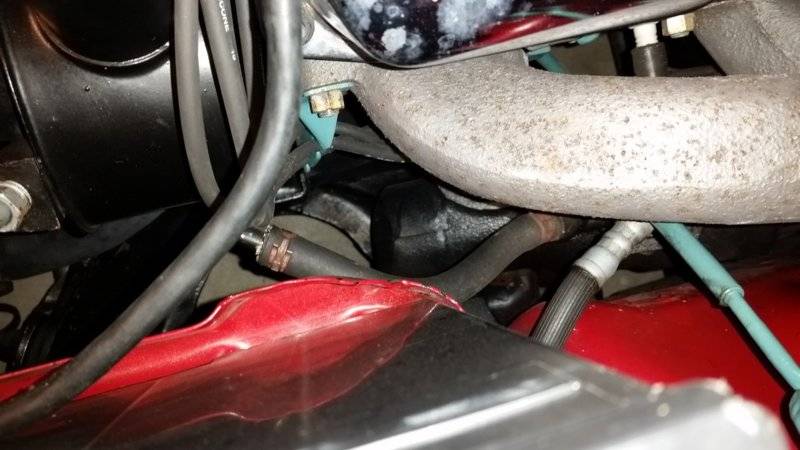

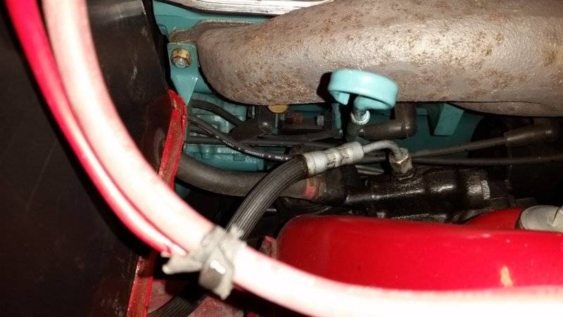

Can you guys post pics of your power steering hose routing?
That was the only way I could route the high pressure hose.
And does the return line hose look too tight to you guys? There is some slack in it, but I'm worried that when the engine moves it'll strain the small pipe on the pump itself.
The system was already filled so it's not as easy as just removing it (although that is still an easy fix).
Maybe have a high presser hose made longer. Return hose maybe a little short, MO.
Scares me to see a high pressure hydraulic hose over a header tube. That spells fire.

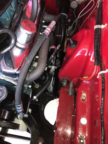

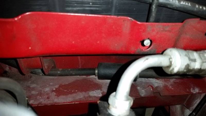

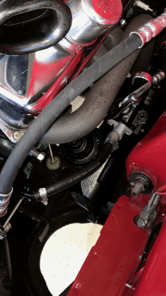

Anyway my hose goes forward then under the battery tray, rests right on the frame rail then to the box.
You can also see the return hose has a little curve to it to give it some flex ability.
