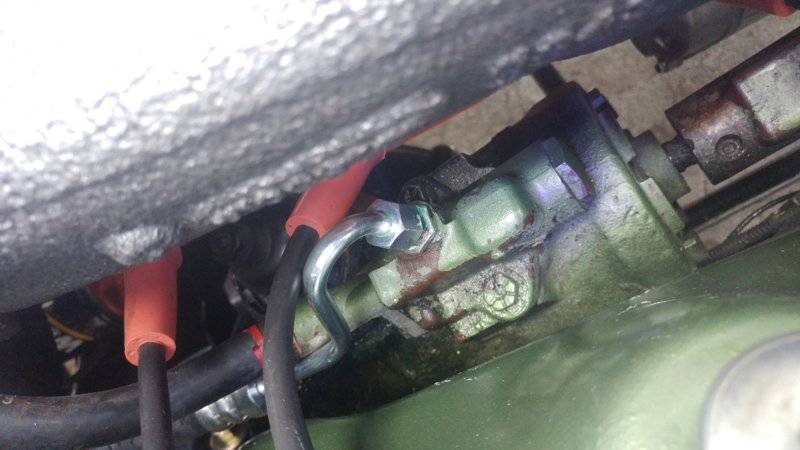

Here is pic of fitting that is leaking...
I had the same problem earlier this year. The fitting was plenty tight, but still leaking. I tried teflon tape too, but to no avail. I removed the nipple that connects the line to the steering box and found a tiny crack in that nipple. I mean TINY! I replaced the nipple and the problem was gone. It hasn't leaked a drop since. Good luck.
Where did you get that fitting from???
A buddy of mine nearby has a salvage yard - got it from him. You can probably get one from Steer & Gear in Columbus, OH too. That's where I got my new updated steering box. They're good guys.
http://www.steerandgear.com/
If I remember correctly, there is supposed to be a copper washer under that fitting and leaks are a memory.
I got a level 3 from steer n gear.... never looked back :thumbsup: As for the line I would suspect cheap/chinese... that stuff can be hit n miss
Look over the flare female / line end real good. Its more of a chance that end has a poor flare or hairline crack. You can crack that female end if you crank down on it to much.
Yeah, I forgot about that washer. Yep, make sure that's there too.
