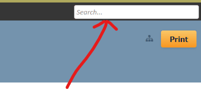

....and this topic has been talked about many times on this very site. :thumbsup:

Don't have a factory manual and can't find past thread about subject.
