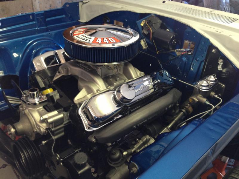

1978 440 engine. Anyone have pics of how the brackets bolt to the water pump? I am just sure this pump and brackets I have,came off my 78 engine, But for the life of me, I can't figger how they go back on. try'ed all kinds of combos and the bolt hole spaceing doesn't jive. Thanks for any help..................................MO

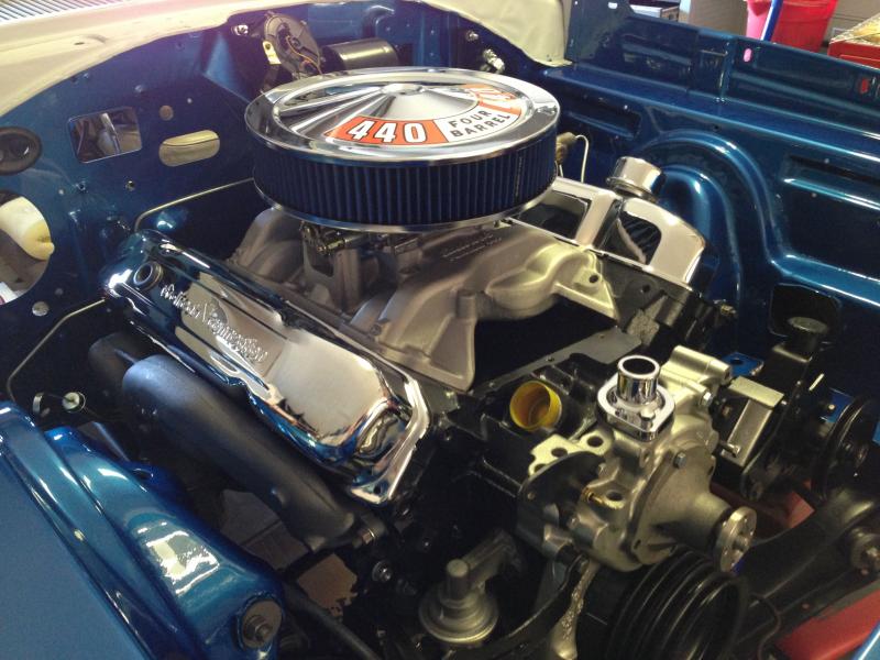

Does this help?
Yes, that does help. Evidently there are some brackets between the water pump and the brackets in the ps pump. Everything being black makes it a little hard for me to see just how they are, but it does give me a clue. I am surprised that the pump is so far away from the engine. Thank you................MO
I did find another bracket, but it doesn't seem to line up with anything either. How many pieces are there beside the two that obviously bolt directly to the pump? Any additional info would be greatly appreciated.............................MO
