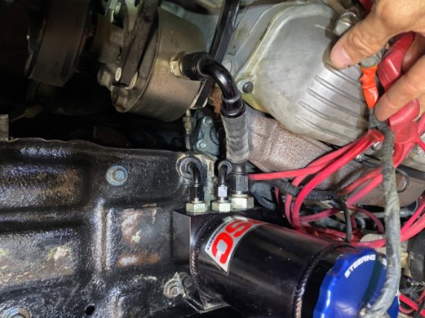

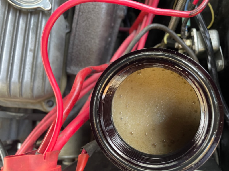

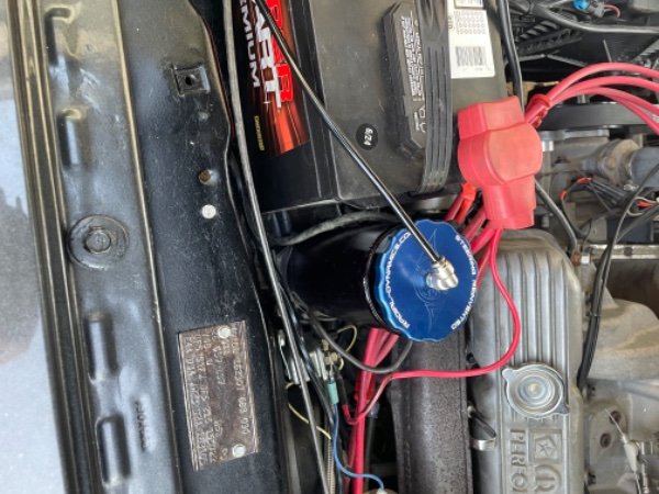

My Saginaw Power Steering pump is forcing its fluid out of the vent hole in the cap like Mount Vesuvius. Fluid level is where its supposed to be when hot but after driving it starts to produce enough pressure to force the fluid up and out.
Taking the cap off with engine idling its is really churning badly. Could be the pressure relief vavle is not working or stuck?
Ordered a rebuild kit and some new hoses=any idead I shold be looking for-thanks in advance-Larry
Sounds like you have air in the system. Check it when cold. Bring it to level and start the car. Shut it off right away and let it sit. I will bet you will have to add . Do this for several times. Once aerated its hard to get it out and worse the more you run it.
Jack it up and turn the wheel lock to lock a few times back and forth.
Keep an eye on the reservoir level.
I just told you is #2 above. You want the system to calm down. Adding fluid on a system full of air just makes it worse.

Most of the time you will not have a problem. However an overly aerated system becomes what I would say angry. Adding fluid just makes it puke worse. Back in the day all the Dodge sno fiters had a belt driven Saginaw pump system. Run them low and they were a bitch do get all the air out. I just find it easier to fill, start, shut off and refill. I do that several times. Then I will turn it one way and back to center, shut off and let it sit a bit. Refill and start it and turn it the opposite way. Repeat. Once it cavitates it just gets worse.
