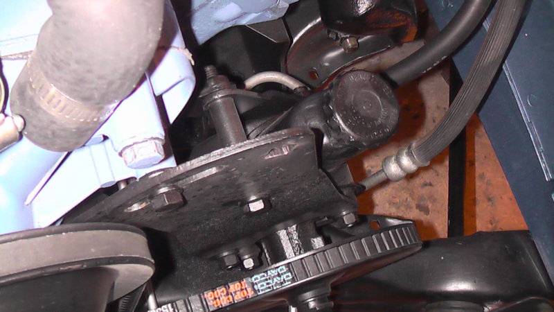

Well the 71 318 no A/C pump has started to leak,I need help getting the right pump,my parts store is having a little problem finding.Rock Auto seams to be the way to go but they have 8 or nine to choose from,i don't know witch 1 to get,any help would be powerful lol,also whats involved on removing the pulley.thanks boys.

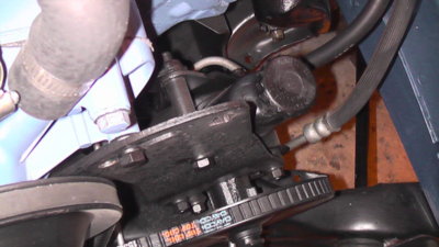

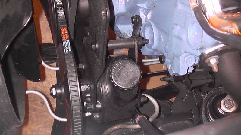

can anyone tell witch pump i have.

Yeah, thought you said NO a/c pump.
That one is with the nut. Maybe a tapered, or keyed shaft. Type puller you want will be a one piece, not the 'jaw' type.
Is that a Thompson? Should be able to search steering pumps, and get a hit.
Don, you have a Saginaw pump, it has a round reservoir

ar67gtx mine is not a press fit.so from what i have read here,remove the bolt on the shaft grab onto the pulley and have someone hit the end the shaft should pop off.we will see WML.
Could be - I have a TRW which is similar to Federal style and they press on. Not sure about the Saginaw pump.
That looks like a Saginaw, Saginaw are oval shape reservoir. Federal and Thompson are round shape.
