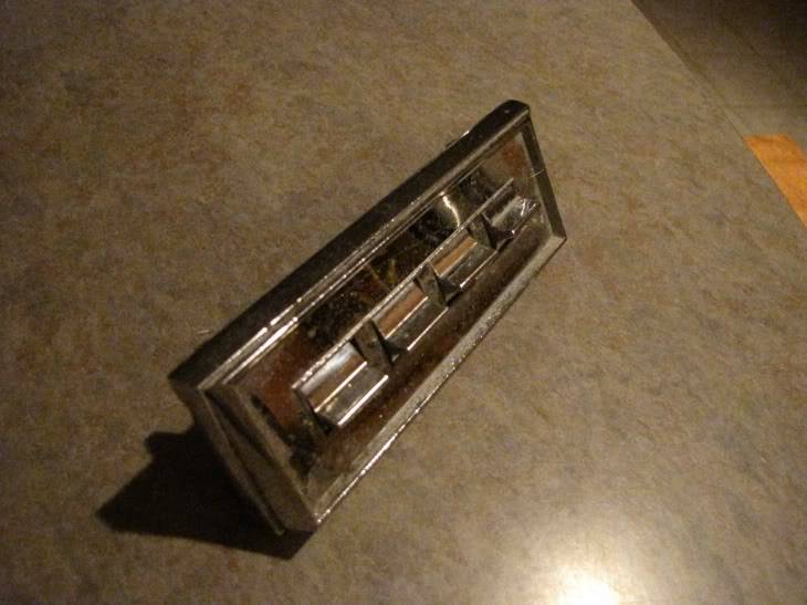

Still got the part amazingly. I think I took this part off in 98'. Hilarious!! Since then, moved 7 times, to 3 different parts of the country, married the divorced then married again, bought a couple different houses and in the end......I still have this old power window switch I took off my Coronet thirteen years ago.
Back when I pulled this part off, I had an idea that power windows were pretty rare in these cars. A couple years later I had Galen Govier document my car and it turned out to be 1 of 58 68' Coronet 500 Convertible's to come with power windows. Probably why I chucked it in a box for safe keeping.
Definitely not show quality. Chrome is peppered pretty good. Looking at it now, it looks like the inner electrical workings could be removed from the cast metal housing and possibly rebuilt. The housing could be rechromed. The first two up/down switches (control for driver-passenger side windows) sag a little bit and have less spring left in them than the other two. I'm betting it could be took apart, contacts cleaned and springs replaced and it would probably work fine. I guess back then I didn't think that far in depth about it and just replaced it.
If you think this switch may have better luck than your old to get your windows up and running, let me know. You can have it..
Here is some pics of it......Same as yours?
