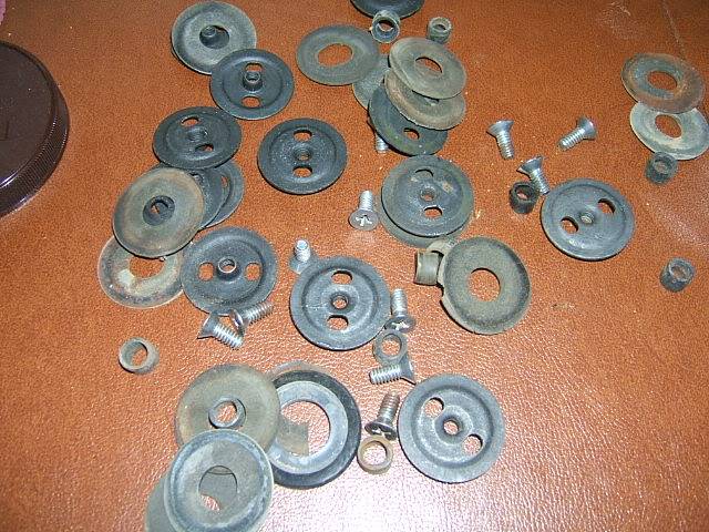

Are those spare parts you wanna share?
sorry,i sold all of my spares the last time
i posted that pic..lol
i would try either moparmark on this site or jimmy boros (recharged on ebay)
might have them.
