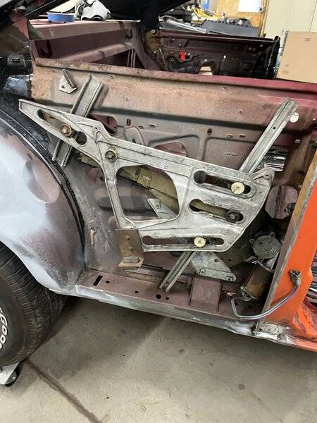

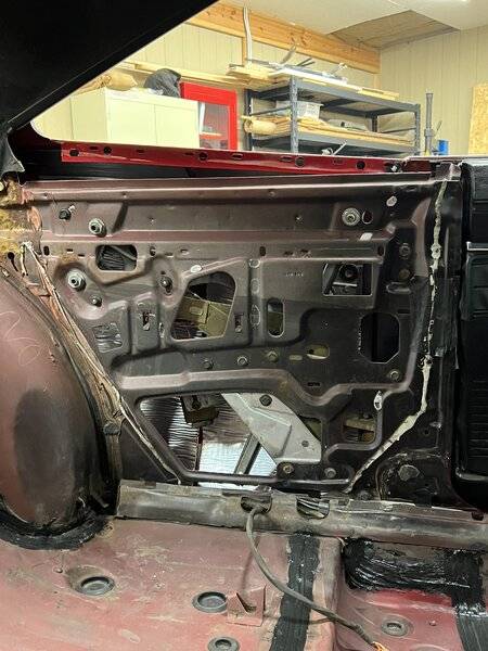

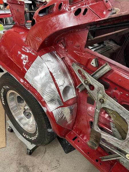

Hi- ‘69 Charger- I have these with my QP’s off so I could put them back together. I’ll take som pics from the inside later on.
I’ll take some inside the quarter panels from in the car.

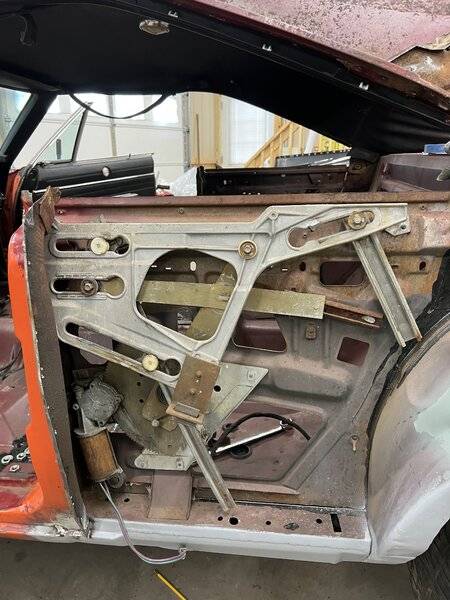

No, I didn't take pictures inside the doors. My car was originally power windows, but had been changed to manual windows by a previous owner. The only thing I had to change were the regulators and add the window motors back, and ofcourse replace the wiring and door switches. It took the better part of 2 years to find all the parts. Steve @3white74 came up with the bulk of what was needed. It was a PIA to get it done, but then all window adjustments and replacement of their parts are for me. Devin @devinism rebuilt all my window switches which was another hurdle. A big thanks to all that helped with mine.

mine was born with manual windows. From the looks of that pic, it seems impossible to do a factory type of swap without removing the quarter panel. Is that an accurate statement?
bighouse
No the regulators come out the top. Try to get a look at the factory service manual.
bighouse
That's what I thought. However, as I had the quarters off anyway, I did the swap without looking further into it.

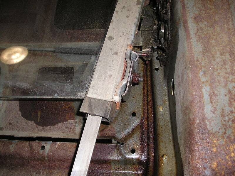

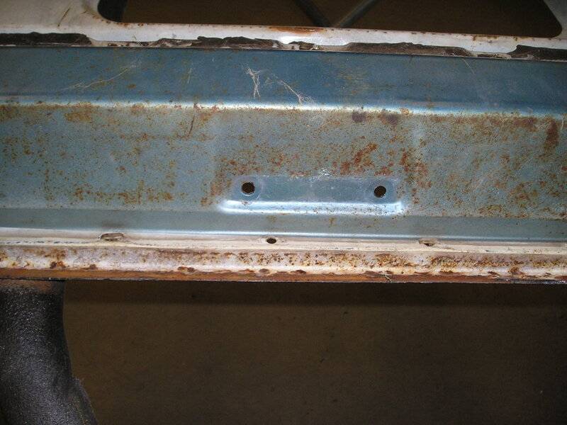

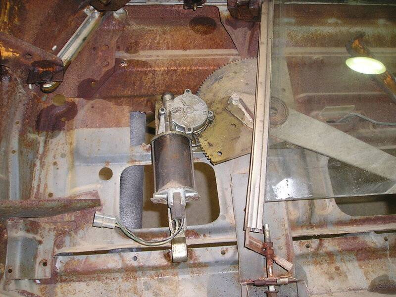

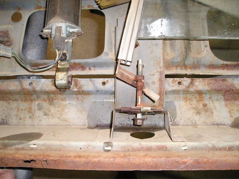

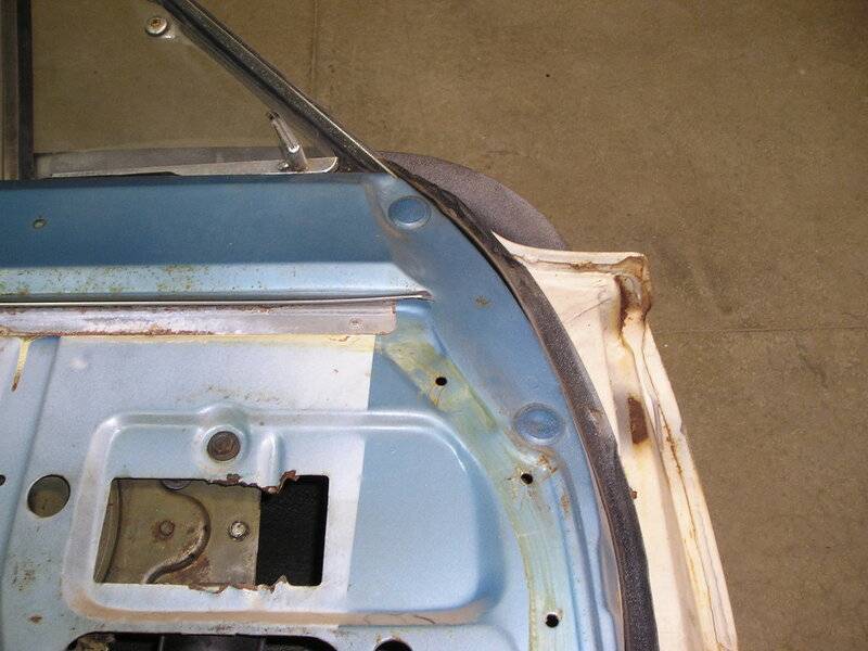

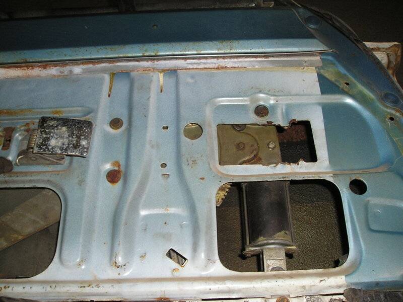

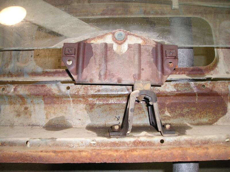

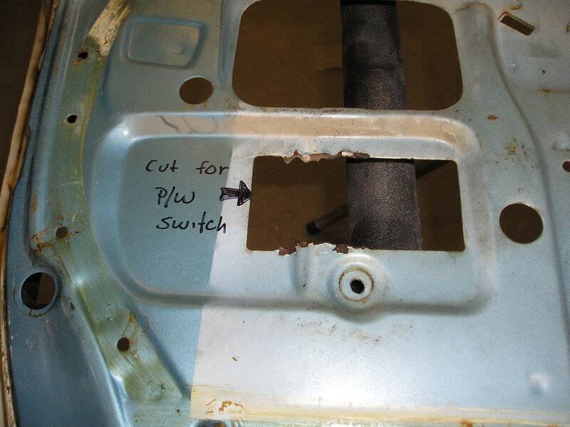

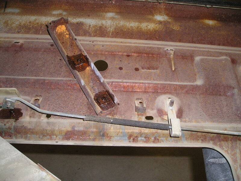

Here's a few pics from a '68 SS convertible. I don't know how helpful they'll be, but take a look.
