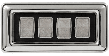

Switch Options Scroll down to select your switches

I personally hate seeing gm PW switches in a Mopar.
That's what you get with most aftermarket PW kits.
Agree, but if you have the Mopar switches it's easy to convert...
Like most stuff new GM switches are available & cheap... A company offering PW kits needs available parts, searching for & sourcing OE Mopar switches would be a fools errand..
