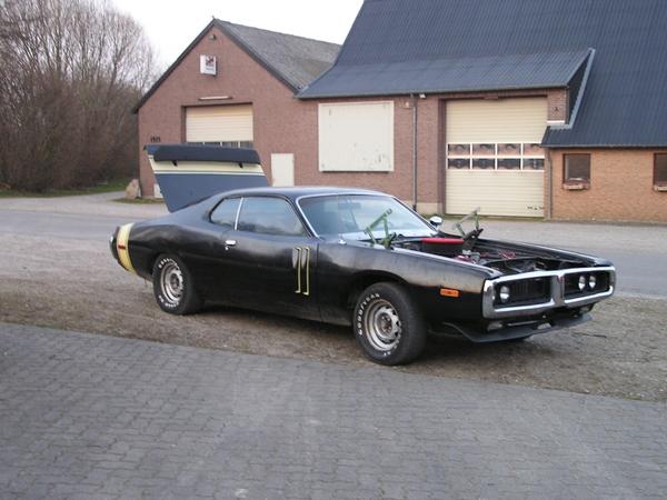

Hi,
will a 73 powerbulge hood fit on a 74 charger ?
THX
B
Yes.
all 71/74 Charger hoods are totally interchangeable, no matter flat or bulged.
Yes it will fit but the 74 Rallye hood does not have the slots in the back like the 73 hood (in front of windshield).
Actually 71, 72, 73 and 74 bulge hoods are all different in appearance.
Still have the 71 doorstripes on my 74. So i wouldn`t mind ^^
well if you get a 74 Hood for a non 74 car, without the grilles, you'll need to move, find, modify, customize the wiper washer nozzles, since on earlier years, these were between the grills, and 74s got them mounted on wiper arms.
Several options for this:
-Get a full 74 wiper arms and nozzles system.
-Open a hole on the hood for the earliers nozzle
-get aftermarket nozzles mounted on hood
But on this case is backwards, so you'll don't care LOL.
