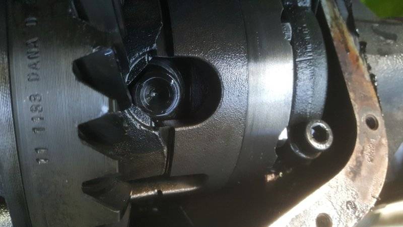

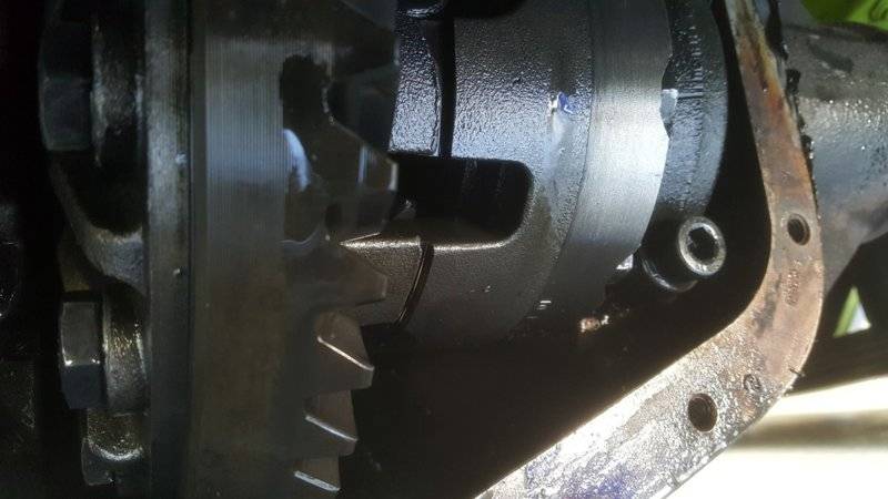

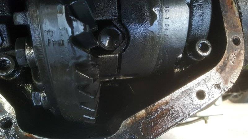

It would sure be nice to see a pic of what's inside once the rear cover is off. Also, you can swap out the side gears (the ones with the splines) to update it to at least 30 spline or even 35 spline instead of swapping out the whole LSD unit. It if is indeed a PL and it's doing all that, then it needs to be looked at. There are pics online that show how the clutches should be stacked and I think Dr Diff has a pic on his site. He can sure tell you how they should be too....
He also has the new side gears with the cross if needed.
Please post a pic, curious minds want to know!

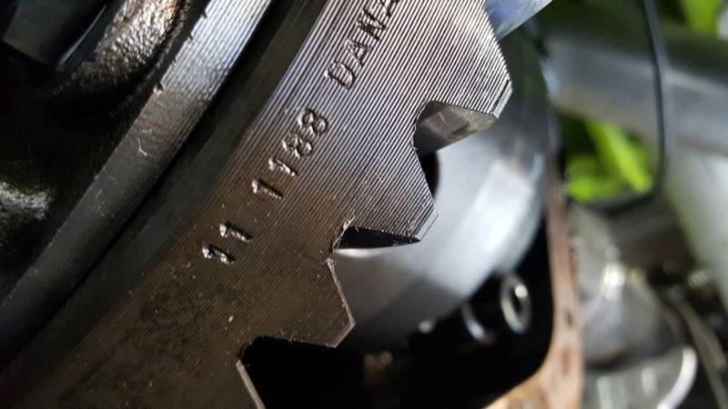

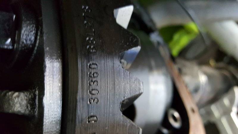

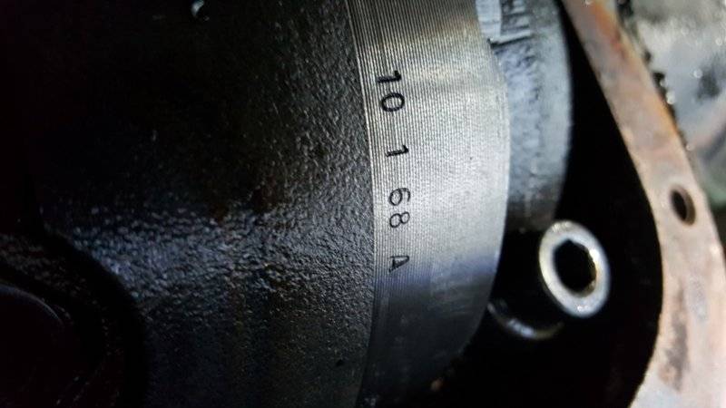

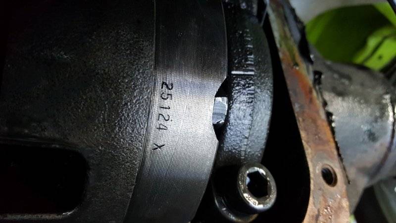

Ok, Here are some pictures. I took them mainly to save the numbers stamped on the case and ring gear. there are a couple of pictures of the cross shaft ends and the "windows in the case. Not much to see.

Also, peeking through the openings I couldn't see any evidence of the spider gears being welded. I suppose they could be but I couldn't see.
I was thinking that maybe the clutch packs could be shimmed so tight before the case half's are bolted together that it would act like a spool but I don't see any adjustment shims. Looks like everything depends on the cone shaped spring rings.

Looks like a Powr-Lok to me. If the clutches are too tight, it can act the way you are talking about. I know that a thinner shim plate (not a clutch plate) is made for the 8 3/4 PL but not sure about the 60. Dr Diff should know about that. Sounds like someone swapped out the 8 3/4 that was in the Cuda and stuck in a B body 60. A measurement will tell you if it's a B body housing. A cast #60 should be on the right side gusset looking from the back. It's not there? Any evidence of someone grinding it off? Just hard to believe someone bought an S-60 and filled it with older technology 23 spline unit and axles but I've seen stranger stuff happen. Also, I'm not sure what an S-60 uses for bearing cap screws but a stock unit shouldn't have socket heads on it....
