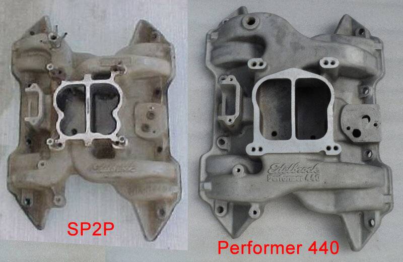

Anyone out there had a problem with ping while using an Edelbrock sp2p intake manifold?
Do you have higher than a 9.0:1 CR? I understand those weren't exactly the most performance oriented intakes.
Lots of causes for ping, usually wrong timing or just bad gas.
Sp2p didn't last long on the market since they didn't perform.
Lean will ping. Is there any indication that an engine might be lean using that intake. LOL What a piece of **** intake. I can’t believe they made and sold those.
You would need a small block with a small cam to even have a chance.
Do you remember the 1979 gas crunch where you could only buy 5-10 gallons of gas at a time. My dad would lean out the jetting to save fuel, and then retard the timing to get rid of the ping. So then his car was a total dog, no power and always running hot.
I agree with R413 the SP2P is a gas crunch intake designed for more mileage, not performance. The ports are very small and restrictive and that can cause a super lean cylinder (ping). It is probably good to about 4500 rpm and then your all done!!!
Maybe 2500 RPM. LOL
flat land and part throttle below 35 mph.
First things first... remove that intake manifold & drop it into your nearest metal recycling container. Substitute with a suitable manifold that performs to your requirements.
And dont get the regular Eddy performer instead...they are related.
I just bought one to put on a 440 in my motor home. Idea is better gas mileage. If it causes and problems it will come off in short order, but I am going to test it for myself with my combo to see what it will do.
