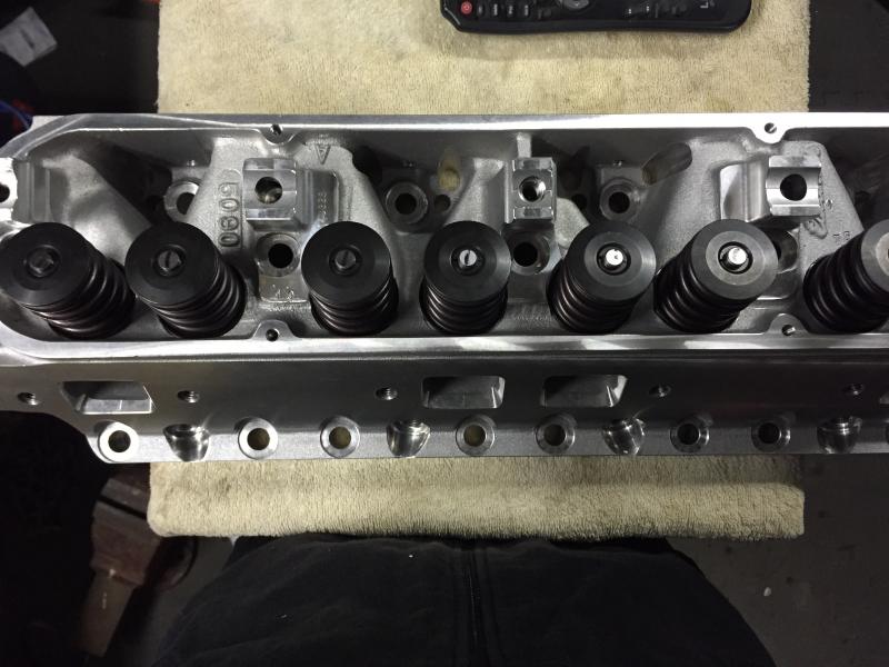

Head have arrived. I'll get some pics shortly. However I was reading through the instructions, while my son took 45 hours to eat his dinner, and I noticed they say in the instructions that I must use a specific bolt kit (theirs 8591). Question is, do I? Or is it marketing? Can I use my existing head bolts and get, say grade 8 washers to protect the head surface?
Mostly concerned about the time it's going to take to order those exact bolts.

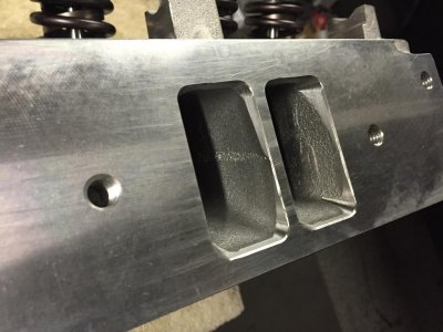

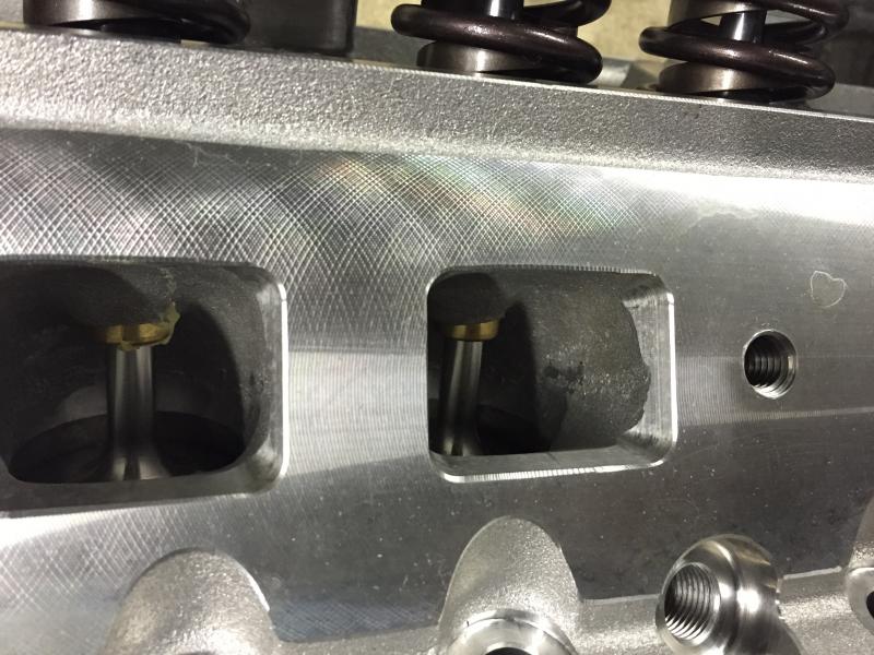

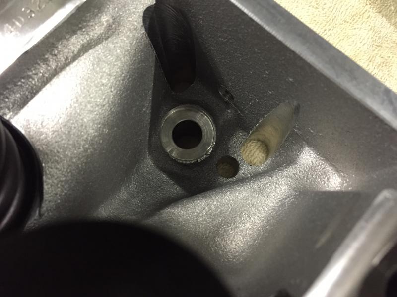

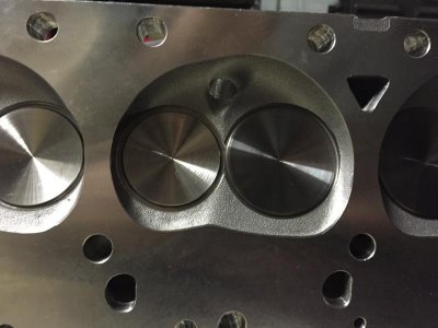

So the heads look good. I'm even more happy with the fact I can just screw bolts in by hand! No grot or grim binding the bolts. Should have done this from the start!
Definitely see what you mean about the castings. The ports have a basic cut to make it meet the port opening but there are some definite steps and casting marks. Having said that I reckon an hour worth of clean up would get these looking really good. Just need to decide if I want disassemble the heads to clean up the ports.
Also comes with studs to replace 4 (2 per head) long rocker shaft bolts. Arp units.
Use the Edelbrock bolts or order ARP bolts for the factory iron heads as they are the same for the Edelbrock RPM.

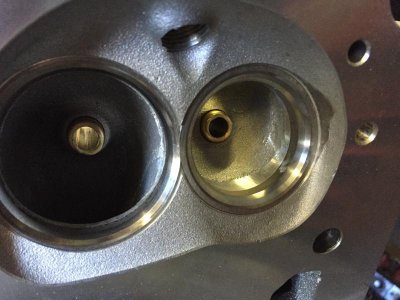

The Performer RPMs say that they come with threaded inserts for durability. How about the E Streets? Do you think they will be just as durable without or are they actually in there and just not mentioned in the description?
Definitely helicoiled as well. From what I can tell its the same head as the rpm, just less finishing and lower rated hardware. The instructions actually have the hardware part numbers so I'll post them up tonight. Thinking I might pop the valves and clean up the heads. I have to cut back part of the head anyway for the vac advance distributed. I'll post some pics and more details shortly.
So the exhaust is helicoiled, the intake isn't.

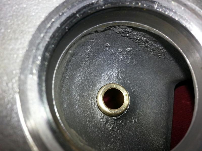

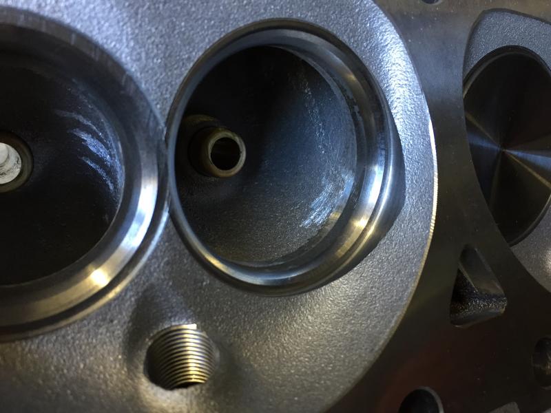

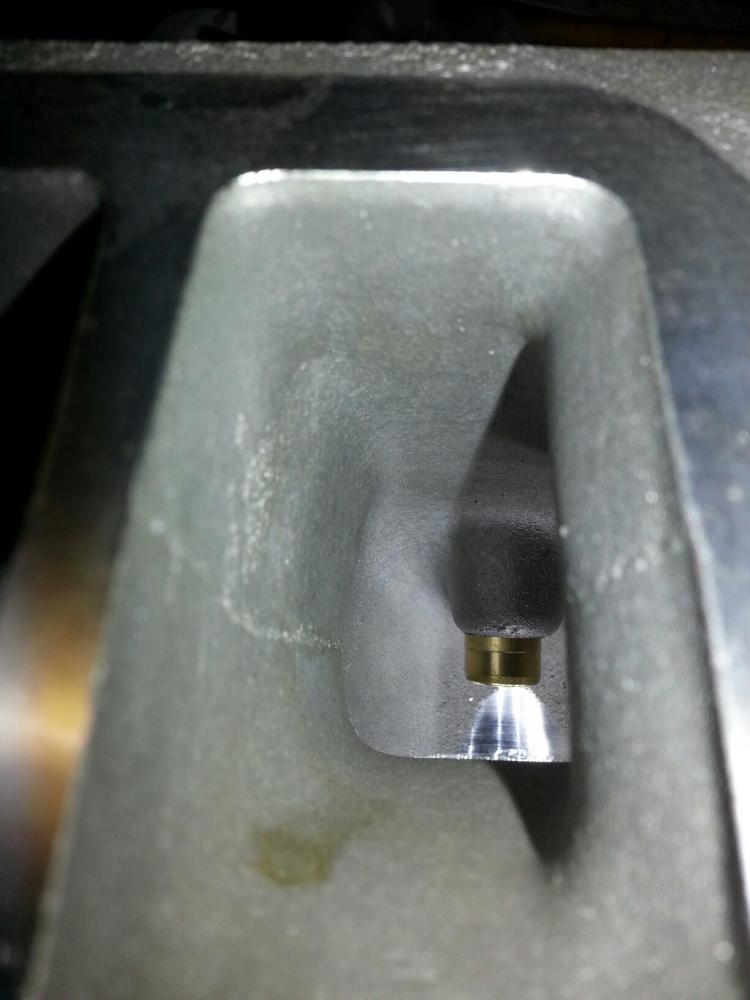

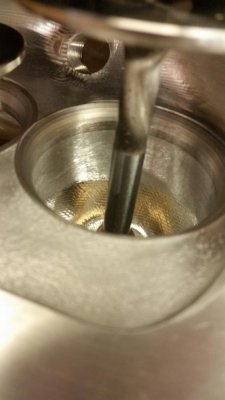

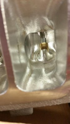

I disassembled one of the heads and have all but finish porting one of the heads. I ran out of light and killed both the bits I was using. I'll finish it up tomorrow night. Here's a couple of pics of the ports behind the valves.
i had Hughes CNC port my Stealths, they sold me a valve job, i assumed that they ched everything out, but when i had my local shop ck them out to set up my springs, they re-honed the valve guides, i noticed some drag when i got them back from Hughes, and sure enough, they needed more light honing.
better safe than sorry.
