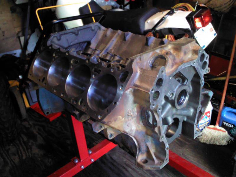

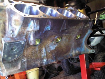

Hey guys I just finally got the last of my parts for my 440 from the machine shop including my block and my balanced rotating assembly. I am going to begin assembly but was kinda surprised at the amount of rust on the block I'm guessing it had been a while since the block was hot tanked. My question is what do you guys usually do before laying paint on the engine. I would hate to clean the outside before assembly as I want to avoid getting any contaminates in the engine. Here are some pics of the block. IMG_20130711_124855.jpg IMG_20130711_124816.jpg IMG_20130711_124846.jpg
Not sure on newer hot tanks, but, its a degreaser, not a rust inhibitor. Tape off everything, then wire wheel. Then, clean every spot, hole, bore, etc. Get a cleaning kit, use it. Remember, no one cares about your stuff like you do.
I would assemble the engine before painting. Saves a lot of masking and insures the insides stay clean......................MO

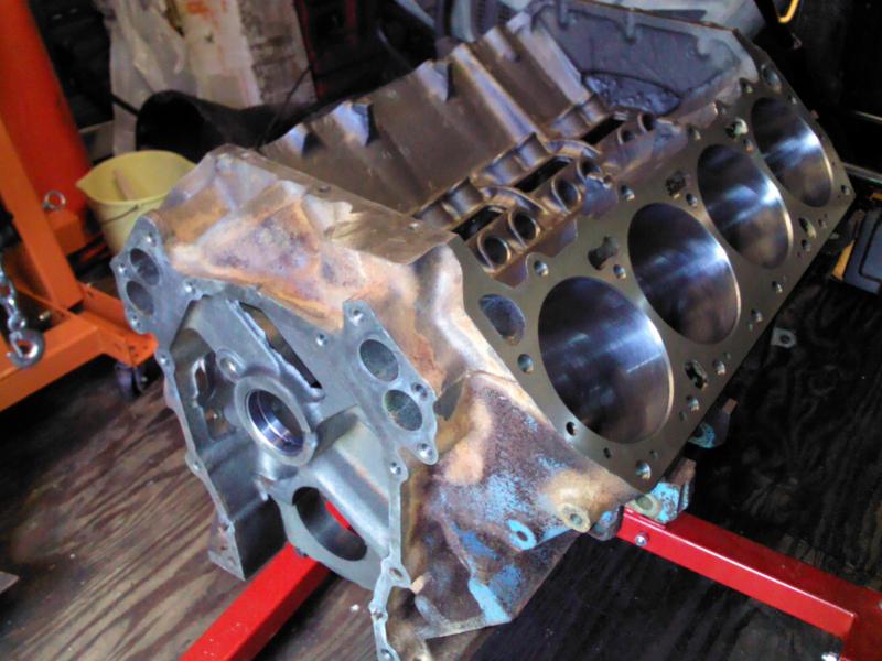

Hey guys I just finally got the last of my parts for my 440 from the machine shop including my block and my balanced rotating assembly. I am going to begin assembly but was kinda surprised at the amount of rust on the block I'm guessing it had been a while since the block was hot tanked. My question is what do you guys usually do before laying paint on the engine. I would hate to clean the outside before assembly as I want to avoid getting any contaminates in the engine. Here are some pics of the block. View attachment 126768 View attachment 126769 View attachment 126770

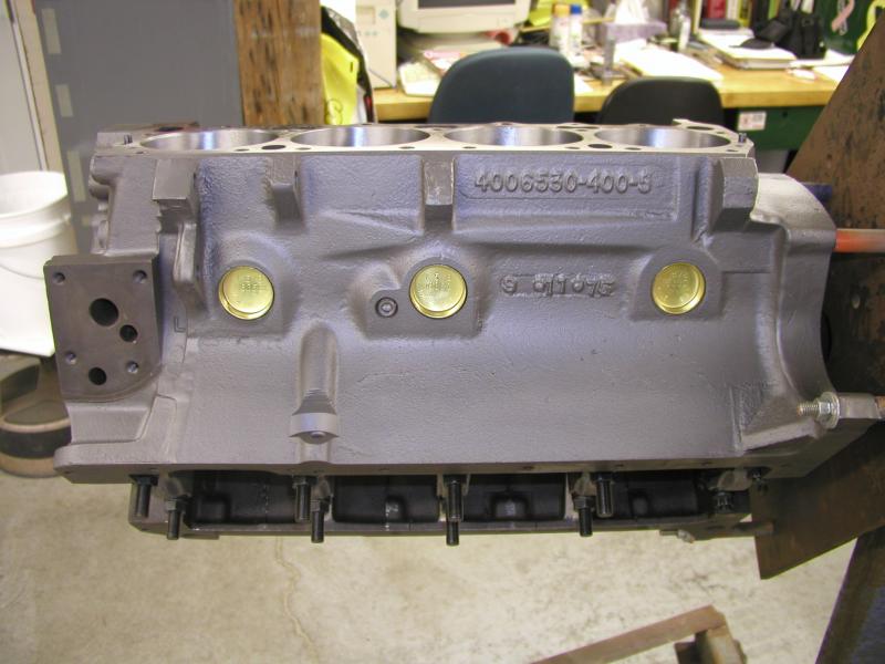

Maybe you should get a new machine shop. Here's what mine looked like when I got it back from machining.

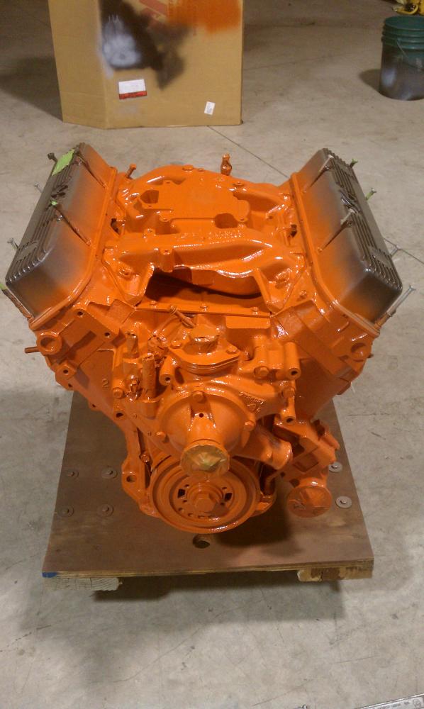

If it were me, just assemble everything that gets painted, tape off any openings, and use a wire wheel to clean it up. Then a light coverage coat of etching primer, then topcoat. Here are some pictures of the process with mine :icon_thumleft:

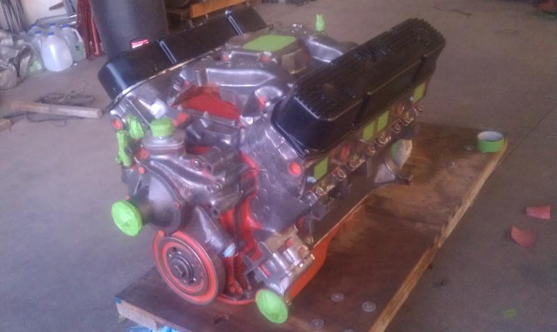

Stripped with wire wheels:

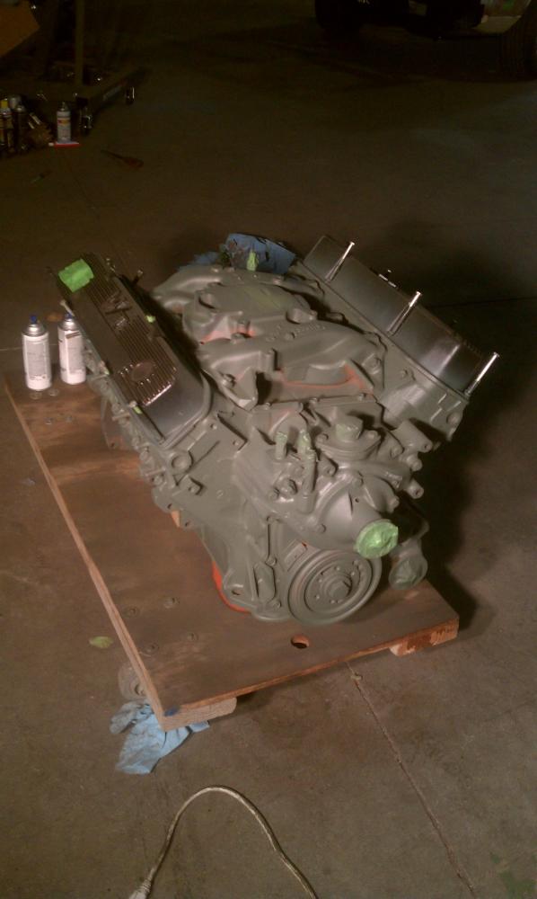

Etch-primed:
Topcoated:

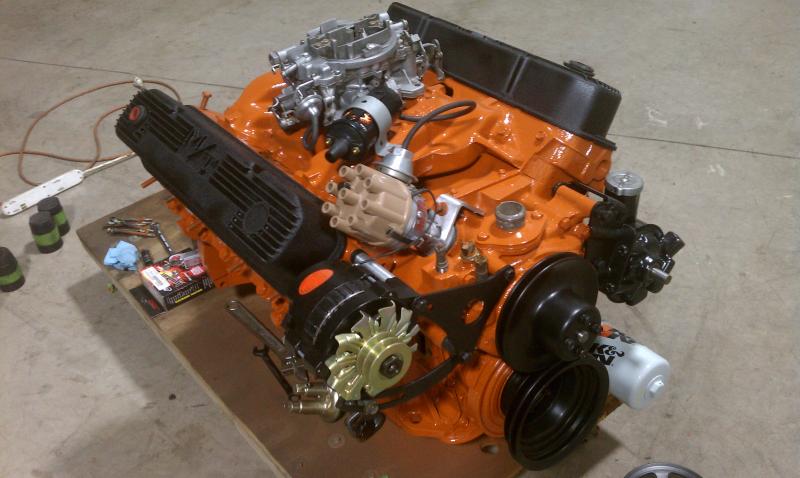

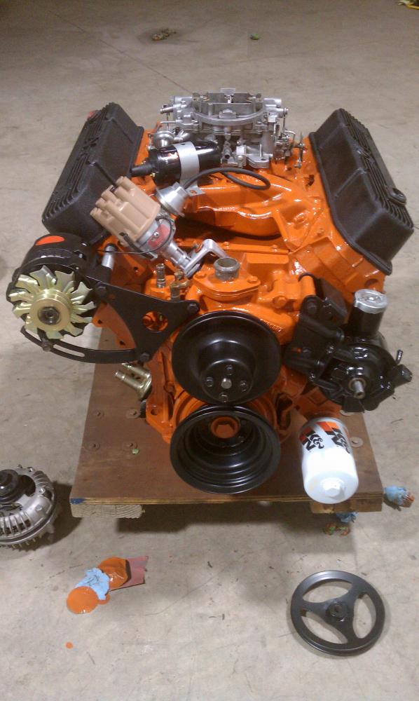

Assembled (kinda):
Unfortunately there aren't many places around here that do machining. I think it built up rust as he had it for 8 months. He is a one man show and is really busy during the winter building engines for dirt track cars. I also know he doesnt bead blast them. I think ill give it a good brushing once its assembled then spray it up. What is the best paint to use.
I just used a single stage semigloss acrylic enamel, not sure if it would be possible for you but I had mine matched to a friend's factory-matched engine paint. Just gave a local automotive paint shop a sample and they mixed a quart up for me
