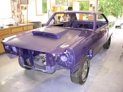

When I restore a car my labor rate is $35.00 an hour. And depending on the car and the shape it is in, is the amount I charge. I've charged as little as $4500.00 and the guy took the car apart and put it back together. it was this purple 71 Dart. It was a pretty clean car.

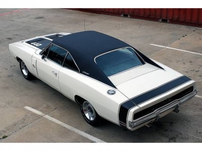

And others like this white Charger was a major project I've charged anywhere from $12k to $16k for something like this.
Like some others have said, it's all about what you want out of your car. If your looking for just a daily driver, or if your looking for a trailer queen sort of speak.
Me just saying, I think your getting a fair price if the guy does good work. Go for it!

Holy smoke- send that guy to me and I'll keep him busy for a LONG time!!
