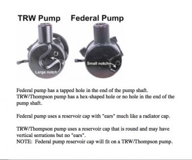

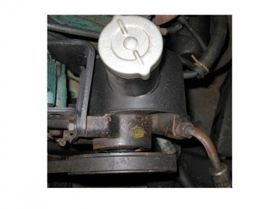

I am looking to convert from from manual to power steering in my 67 Gtx, I have everything except the power steering pump. Does anyone have an up close pic of the proper power steering pump for this car? Is it "federal style"? Does anyone have one for sale complete with brackets and pulley appropriate for 1967 440 Gtx? Does anyone know of quality American made reproduction 67 440 gtx brackets and pulley? Thanks for any relies..
here's a photo of the pump.I have a TRW in my 67GTX....

Thanks for the taking the time to post, it is much appreciated
