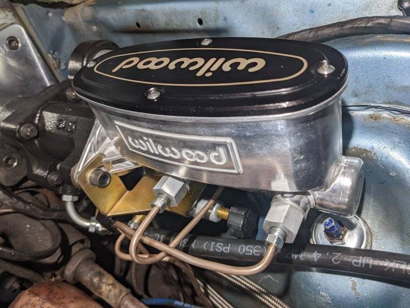

I'm mocking up my brake master and proportioning valve on my 67 Charger and I'm wondering "how close is too close" ?
I suppose I can probably put some kind of shielding here, but I can't be the only person using this setup. This is with a 440, am I going to have problems with heat?

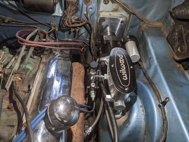

Are you able to mount it on the other side of the Master? Looks like it's set up for either side
Doubtful, it's super tight over there.
That heat shield is something I can see myself doing even I give up on this proportioning valve. It doesn't look like it will do anything for the proportioning valve though.
On my '67 Coronet, I've got room for days between headers and master cylinder, and the lines exit on fender side at a 90° going down to distribution block. And there is plenty of room on that side also. Is that Wilwood master offset towards the engine?

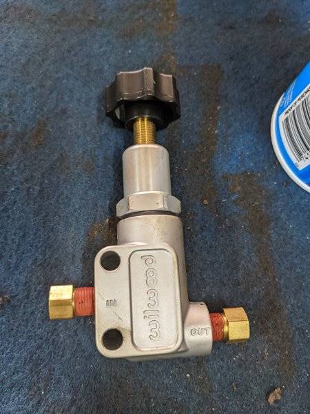

The master isn't offset, but I am using the outlets on the engine side because there is no room on fender side. Yeah I'm sticking with the stock intake for now, it sure made things easy when I had to replace the starter. I may just plumb one of these into the rear line and send this black Wilwood proportioning valve and kit back.
I have one of those universal brackets and am going to mount the same Wilwood valve to the bottom with the adjustment knob sticking out.

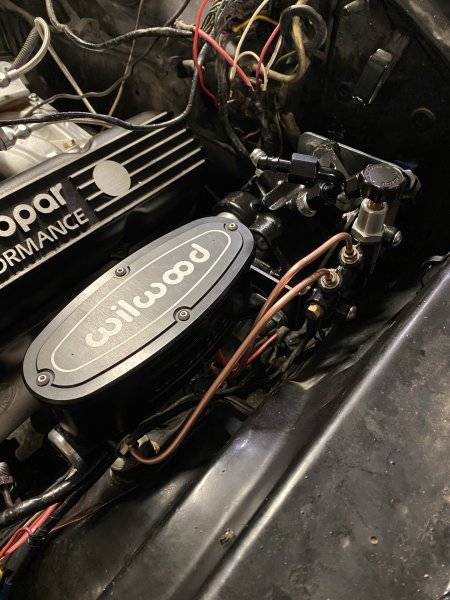

I ended up getting a bracket and modifying it to fit how I wanted. Not perfect but it'll be functional, serviceable and keeps the valve usable but out of the way.
I ended up flipping the bracket around I believe and put it on the other side. I liked it a lot like this.
