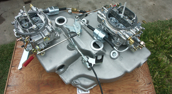

heres what you need complete on ebag
http://www.ebay.com.au/itm/291056303334?redirect=mobile

Tough question to answer. My main 2 reasons for running the factory cross ram: 1) WOW!! factor when you open the hood and 2) I wanted one in 1963 and couldn't afford it. In order to run a cross ram on a car that is driven regularly you need to be educated and committed to learning how to tune it yourself. You learn that a 5-10 minute warm up (even with manual chokes) is necessary before you get a stable idle. Once the motor is up to operating temperature it is very well mannered on the street. My set-up with two 500 CFM Edelbrock carburetors gets right at 10 MPG ( 4 speed / 3:91 rear). With 750 CFM carbs, it got 7 MPG. I have no doubt that getting rid of my high dollar ported and polished max wedge heads and manifold and replacing them with a modern set of aluminum heads and a single four barrel would produce quite a bit more horsepower, but, on the street, I really have all I can handle now.

You can always sell the factory piece and buy an A&A intake with 440 ports. I can tell you where to get low cost linkage parts but I have to dig out my list. I bought a bunch of stuff for mine and saved quite a bit.
The factory ran twin 500 carbs on the 413 in 1962, and that is what I plan to run on my 440 with the A&A x-ram.

Yeah unless someone reports an issue I don't see why it wouldn't work. The angle of the flange on the manifold side of the head should not be any different than stock. If there is any doubt just ask Edelbrock before you order, they would be aware if there is an issue. Same with the carbs, ask Rick Allison of A&A about your combo. The factory used Carter #3447 AFBs on the 413, which I believe rated at 525 cfm (this has been inflated to 600 over the years). I have ported 915s so I went with eddy 1404s which are rated 500-550 cfm. If you are going with the eddy heads and the factory intake I would go with 750s, but Rick will probably know more and also he sells carbs.
426 motors used the carter 3705 which was a 750 cfm.
I built a 440 with eddy heads and a stock 63 cross ram about 7 years ago. Matched the ports to max wedge opening. It runs the stock 3705 carbs, but I've run 600 and 750 Eddys as well with good success (you can buy them used cheap). Originally we ran ran a [email protected] Comp hydraulic. Later it was switched to a similar duration hydraulic roller. Car drives great. Takes a minute or two to warm up then go. 14 MPG w/3.55 and a 5 speed manual. For what its worth this same stock intake ran 10 teens on my 63 Dodge drag car w/Indy -1s (unported) and a .670 roller.
